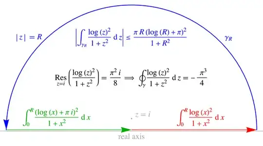

Using a semi-circular contour
Enter image description
and noting that $$ \int_0^\infty\frac{\log(x)}{1+x^2}\,\mathrm{d}x=0 $$ we get $$ \begin{align} -\frac{\pi^3}4 &=\oint_\gamma\frac{\log(x)^2}{1+x^2}\,\mathrm{d}x\\ &=\int_0^\infty\frac{(\log(x)+\pi i)^2}{1+x^2}\,\mathrm{d}x+\int_0^\infty\frac{\log(x)^2}{1+x^2}\,\mathrm{d}x\\ &=\int_0^\infty\frac{\log(x)^2-\pi^2}{1+x^2}\,\mathrm{d}x+\int_0^\infty\frac{\log(x)^2}{1+x^2}\,\mathrm{d}x\\ &=2\int_0^\infty\frac{\log(x)^2}{1+x^2}\,\mathrm{d}x-\frac{\pi^3}2\\ \end{align} $$ Therefore, $$ \int_0^\infty\frac{\log(x)^2}{1+x^2}\,\mathrm{d}x=\frac{\pi^3}8 $$
