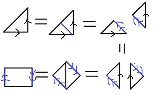

From your other question it seems that you've figured out how to show that the quotient is a Mobius strip. For sake of completeness, here's the argument in pictorial form (I apologize for the crude drawings.): enter image description here

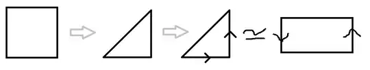

Regarding the last step, maybe this (even more poorly-drawn) picture would help: enter image description here

  • Tbh i actually havent been able to figure out (in formal detail) the last step for the picture: from the triangle back to the rectangle with sides "twisted". I moved on without the formal proof because i had spent quite some time on this without getting it. If you could outline that as well i'd be very thankful! I will also have to take sometime to digest your comment on my new question (and im at work). Again, thank you! – Nap D. Lover Aug 31 '16 at 14:05
