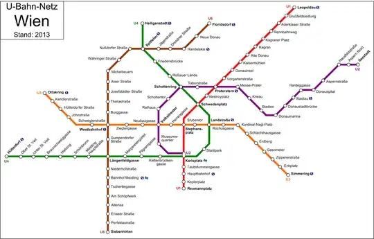

I'll try to illuminate the definition you quoted with an example. Consider this graph of the subway map of Vienna: subway map of Vienna
By User:My Friend - Own Work, CC BY-SA 3.0, https://commons.wikimedia.org/w/index.php?curid=7684906enter image description here
The vertices of this graph are the stations.
Define an equivalence relation on the set of vertices by
$v_1 \sim v_2 \mbox{ iff } v_1 \mbox{ is on the same subway line (e.g. U1, U2,...) as } v_2$.
Here, we need to modify the graph slightly and treat stations where you can change between lines (for example Westbahnhof) as two different, but connected vertices, i.e. Westbahnhof-U3 and Westbahnhof-U6 (you can think of these as different subway platforms instead of stations).
Then there are exactly five equivalence classes (as many as there are subway lines). These equivalence classes are sets of stations, e.g.
$$[\mbox{Heiligenstadt}]= \{\mbox{Heiligenstadt, Spittelau-U4, Friedensbrücke,}\dots\}.$$
Every stop on a given line is a member of the equivalence class associated with this line.
The definition of the edges on the quotient (that $[u][v]$ if $uv$) ensures the following: For two given equivalence classes of edges (i.e. subway lines), if there is a station which where you can switch between these lines (e.g. Westbahnhof-U3 and Westbahnhof-U6), then these equivalence classes are connected.
The resulting graph describes the connectedness of the subway lines, not the stops.
This results in a graph where U1 has an edge with U2, U3 and U4; U2 has an edge with U2, U3 and U4; U3 has an edge with U1, U2, U4, U6; U4 has an edge with U1, U2, U3 and U6; U6 has edge with U3 and U4. It should look like this, except the $5$ represents U6.
