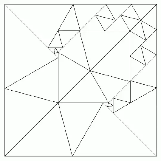

46 triangles of type $45^\circ-60^\circ-75^\circ$ can perfectly cover a square.
Ed Pegg
