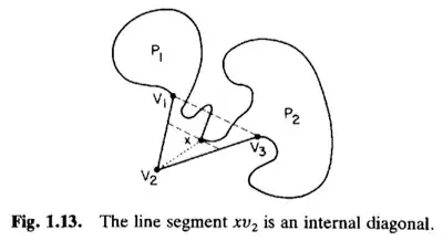

EDIT **** SATURDAY: A very good proof and discussion is given by Joseph O'Rourke, website OROURKE in Chapter One of his book Art Gallery Theorems and Algorithms, which one may download as separate chapters. In Chapter One, "Polygon Partitions," page 12, there is a quick proof for your question, as part of Theorem 1.2. Take three consecutive vertices $v_1, v_2, v_3$ such that the angle is "convex" with regard to the polygon $P$, that is, a tiny neighborhood of $v_2$ inside the angle $v_1 v_2 v_3$ (demanded below $\pi$) is also inside the polygon $P.$
          Diagonal proof
Perhaps $v_1 v_3$ is a line segment completely contained in $P,$ in which case we are done. If not, it means there are other vertices of the original polygon inside the triangle with vertices $v_1, v_2, v_3.$ Find the vertex, call it $x,$ that is inside the triangle and is closest to $v_2,$ distance measured only in the direction perpendicular to segment $v_1 v_3$ (see Figure 1.13). As a result, the line through $x$ and parallel to $v_1 v_3$ can not intersect any other edges of $P$ inside the triangle $v_1 v_2 v_3.$ Then the segment $v_2 x$ is completely inside $P.$ . Note that measuring distance for $x$ by full Euclidean distance may not work properly here. Draw some pictures! On page 13, he mentions Meister's Two Ears Theorem (1975), Theorem 1.3, which is probably the item you saw quoted.

    Thank you, Will! I added the figure that makes it clearer. I'm embarrassed to say this proof is not only in the book Will cited, but also in the two later books, Computational Geometry in C and in Discrete and Computational Geometry. – Joseph O'Rourke Nov 20 '11 at 22:26
  • Thanks, Joseph. I note that the round part of $P_2$ resembles a kidney. Or an ear. I noticed, eventually, that your proof does work for the case when the "closest" point $x$ is on the segment $v_1 v_3$ itself, but not equal to $v_1$ or $v_3.$ – Will Jagy Nov 20 '11 at 22:52
