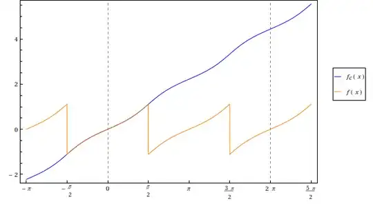

Consider the function
$$f_c(x)=\frac{x}{\sqrt 2}-\frac1{\sqrt 2}\arctan\left(\frac{\sin\,2x}{3+2\sqrt{2}+\cos\,2x}\right)$$
You can check that the derivative of $f_c(x)$ is $\dfrac1{1+\cos^2 x}$. The relevance of this function is that $f_c(x)$, unlike the function $f(x)=\dfrac1{\sqrt 2}\arctan\left(\dfrac{\tan\,x}{\sqrt 2}\right)$ given in the OP, has no discontinuities within the integration interval $[0,2\pi]$:
plot of two antiderivatives
Thus,
$$\int_0^{2\pi}\frac{\mathrm dx}{1+\cos^2 x}=\left.\frac{x}{\sqrt 2}-\frac1{\sqrt 2}\arctan\left(\frac{\sin\,2x}{3+2\sqrt{2}+\cos\,2x}\right)\right|_0^{2\pi}=\pi\sqrt 2$$

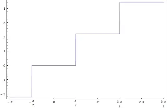

One wonders how the two functions $f(x)$ and $f_c(x)$ could look so different and yet have the same derivative. A plot of $f_c(x)-f(x)$ shows the difference:
f_c(x)-f(x)
Here, we see that the two functions differ not by a constant, but by a piecewise constant function (i.e., a step function). In fact, the Fundamental Theorem of the Calculus can be stated a bit more generally than is usual in textbooks. To quote Oleksandr Pavlyk's blog entry on this subject,
Every calculus student knows that antiderivatives can contain an arbitrary additive constant. But in fact, there’s more arbitrariness than that: one can add different constants on different parts of the interval.
