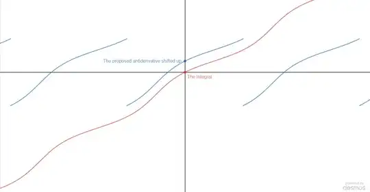

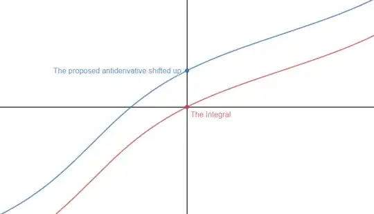

We have the following definite integral:
$$f(x)=\color{#dd1111}{\int_0^x\frac{dt}{2+\sin(t)}}\stackrel?=\color{#4488dd}{\frac{2}{\sqrt{3}}\tan^{-1}\frac{2\tan \frac{x}{2}+1}{\sqrt{3}}}-\frac\pi{3\sqrt3}$$
At first, I wouldn't doubt this solution:
But then I look at the big picture:
It's not that the integral in question is discontinuous, it's that
a) the proposed solution is discontinuous for fixed constant.
b) a u-substitution was made that was not valid for $|x|\ge\pi$. To remove this problem, one could take $n=x\text{ mod }2\pi$ so that we make the argument between $(-\pi,\pi)$ and add in a linear piece of $n\int_{-\pi}^{\pi}\frac{dt}{2+\sin(t)}$.
