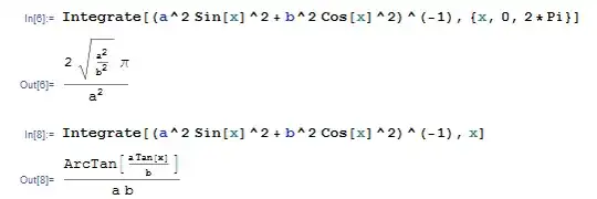

On the one hand, the substitution is correct, as well as the indefinite integral itself (according to Wolfram it is indeed $\frac{1}{ab} \arctan \left(\frac{a}{b}\tan\theta \right )$ ), but on the other hand I can see that had I put the limits during the substitution I'd get $\int\limits_{0}^{0} \dots = 0$ because for $\theta = 0 \to u=0$ and for $\theta = 2\pi \to u=0$.

Edit: Here is Wolfram's answer: enter image description here
Wolfram is correct because $$\frac{a^2 b^2}{2}\int\limits_{0}^{2\pi} \frac{d \theta}{a^2 \sin^2\theta+b^2 \cos^2\theta}$$ is the area of an ellipse (defined by $x=a\cos t , y=b\sin t$), that is $$\frac{a^2 b^2}{2}\int\limits_{0}^{2\pi} \frac{d \theta}{a^2 \sin^2\theta+b^2 \cos^2\theta}=\pi ab$$

Note that this is a good warning about using Wolfram (or any formal computation system) : the formula for the indefinite integral is good, but it holds only on each interval $(k\pi -\pi/2, k\pi+\pi/2)$, which the program does not tell you.
