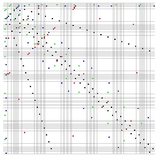

Illustration: This is a plot of the $m,n<131$ for which there exists $t<n+m$ such that $m,n,t$ is a non-trivial solution to the equation $ S(m,n+m,t)=\sum_{i=0}^{t}(-1)^i\binom{m}{i}\binom{n}{t-i}=0 $
The green, blue and black dots correspond to the above polynomial families of solutions, and the red dots are for the other non trivial solutions.
The red dots look more sporadic but there are some patterns too. Most of them belong to one of the following nine "exponential" families of solutions $m(k),n(k),t(k)$ which are defined by second order linear recurrences. (And the corresponding associated families according to the above symetries).
