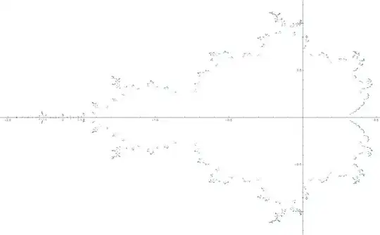

Here is a plot of 17,723 Misiurewicz Points. The code below generates a set of polynomials u[m,n], the roots of which have periodicity (m-n) starting at iteration n. I stopped at 17,723 points because to get more by this method I had to generate and solve $2^{11}$-order polynomials. In other words, I hit the practical limit of my method.
Misi17723
So my question is: Is there any way I can find more Misiurewicz points without having to solve giant polynomials?

These settings will produce a plot in few seconds. The jpeg above took a while and was generated with
ord=11;
plotOrd=11;
and
Print[ListPlot[Transpose[{Re[rts], Im[rts]}],PlotStyle ->PointSize[Tiny]]];

    The parabolic and Misiurewicz points can be parametrized by the rational numbers between 0 and 1 using the idea of an external ray. The Wikipedia page provides a serviceable introduction, this paper provides a modern account, and Milnor's book is excellent as well. External rays are not hard to compute and you can use one to get close to a Misiurewicz point. I could provide more details over on Mathematica.se, if you like. – Mark McClure Feb 06 '16 at 23:31
  • @MarkMcClure Thanks, that would be great. But I think it would be kosher to post MMa code here, since it's the answer to a math question. – Jerry Guern Feb 06 '16 at 23:47
  • @MarkMcClure paper link has rotted. Archive copy: https://web.archive.org/web/20170519212111/http://dynamics.user.jacobs-university.de/wp-content/uploads/2015/12/DouadyPaper2015_red.pdf Rational Parameter Rays Of The Mandelbrot Set Dierk Schleicher – Claude May 23 '19 at 14:06
  • @MarkMcClure book link has rotted. Dynamics in One Complex Variable: Introductory Lectures John Milnor (2nd Ed, 2000) – Claude May 23 '19 at 14:14
Using numerical methods, like:
  1. Misiurewicz domains
  2. Newton's method for Misiurewicz points
