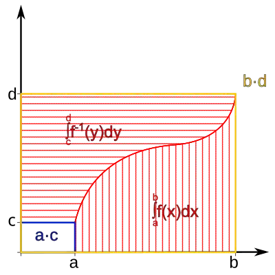

Too long for a comment :
As far as definite integrals are concerned, there are no currently known methods of actually proving that they do not possess a closed form. $($ In other words, there are no equivalents of Liouville's theorem or the Risch algorithm for definite integrals $).$ So what I'm about to write
does not constitute “proof” of anything, but serves merely as an intuitive explanation for why
it is unlikely that the integral you posted to have a “meaningful” closed form. Notice that the
other two integrands possess an inverse, i.e., $$y~=~\arctan^n(e^{-x})~\iff~x~=~-\ln\tan\sqrt[n]y~=~\ln\cos\sqrt[n]y~-~\ln\sin\sqrt[n]y~.$$ At the same time, remember the well-known relation between the definite integral of a function, and that of its inverse:
$\qquad\qquad\qquad\quad$
Applying it to the former two cases, it yields something manageable, following a substitution of the form $y=t^n.$ The latter integrand, however, does not exhibit such auspicious traits, since its inverse cannot be expressed in terms of any known functions, be they either special or elementary.
