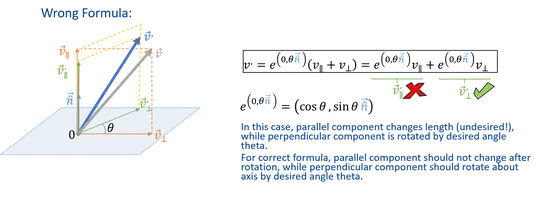

If it were $\cosθ+a\sinθ$ instead of $\cos(θ/2)+a\sin(θ/2)$, then rotation of $\pi$ about any axis would give you the same result.

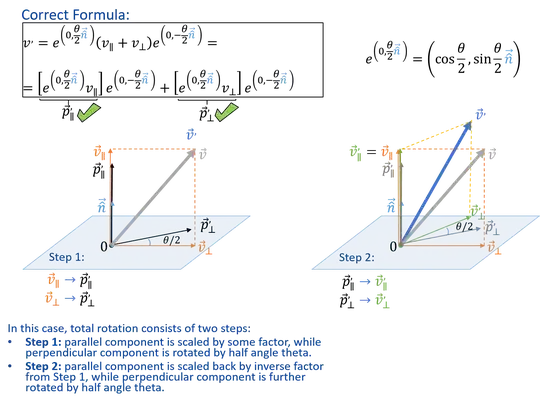

Related to the first quote, one answer to the question linked above suggests that the reason for using $\theta/2$ is to, given a vector $p$ to rotate expressed as a pure imaginary quaternion, keep the resulting rotated vector after a conjugation operation $qpq^*$ in the pure imaginary 3D space (essentially, the multiplication from the left rotates it $\theta/2$, but also moves it out of the imaginary 3D space - then the multiplication from the right moves it back into the imaginary 3D space and rotates it $\theta/2$ again for a full rotation of $\theta$).
