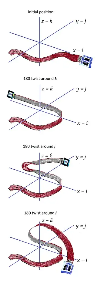

The belt trick can also be used to demonstrate $\mathbf{ijk}=-1$, but first we have to figure out how to interpret quaternions as rotations. (The whole reason they were discovered/invented in the first place was to generalize the use of complex numbers describing 2D rotations to 3D.) Unit quaternions have polar forms $p=e^{\theta\mathbf{v}}$ for unit vectors $\mathbf{v}$ (i.e. square roots of negative one, so Euler's formula applies), and the effect of conjugating a 3D vector $\mathbf{x}$ by $p$ (yielding $p\mathbf{x}p^{-1}$) is rotating $\mathbf{x}$ around the oriented axis $\mathbf{v}$ by the angle $2\theta$.
Since $\mathbf{v}$ has polar form $\exp(\frac{\pi}{2}\mathbf{v})$, the corresponding rotation is $180$ degrees around $\mathbf{v}$ (in either direction). So, take a belt and hold it straight out in front of you (like nunchuks I guess?). Pay attention to the orientation of the belt buckle, as you (in order) rotate it around the $\mathbf{k}$-, $\mathbf{j}$- and $\mathbf{i}$-axes. The effect is the buckle itself will be back to its original position, but the belt will have a $360^{\circ}$ twist in it, represented by the quaternion $-1$.

  • Can you sketch a drawing? – Antoni Parellada Sep 30 '18 at 23:45
  • It'd take some time and effort to draw that carefully. Maybe someone can record me doing it tomorrow. But it'd be easiest if you just do the process correctly. Rotate $180^{\circ}$ around the the three axes in the correct order. You need to do $z$-axis, then $y$-axis, then $x$-axis, and make sure your axes are oriented according to the right-hand rule. If you do them out of order, you will wind up with something equivalent to $0^{\circ}$ (which $720^{\circ}$ is) because ${\bf kji}=+1$. – anon Sep 30 '18 at 23:54
    Okay I had to take a picture with my nose a couple times but here's four pictures. You can also do a different illustration of ijk=-1 with your hand, see here. I will update my answer with more details from these comments sometime later this week. – anon Oct 01 '18 at 00:37

THIS IS NOT AN ANSWER - Just an appendix / extended comment that doesn't belong to the original post...
@anon's answer contains a "belt trick" to illustrate the $\bf{ijk}=-1.$ Explained in words was rather confusing, but (after his pictures holding his belt included in the comments to his post as a link, I believe the idea can be illustrated as follows:
Here is the part of @anon's answer relevant to the illustration:

A rotation of $180$ degrees around the unit imaginary vector $\vec {\bf v}$ will correspond to
$$e^{\frac \theta 2 \vec {\bf v}}=e^{\frac\pi 2 \vec {\bf v}}$$
Here's a link.
