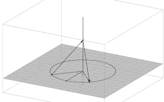

My understanding of the reason half angles are generally used with quaternions is that when you have a point in 3-D space, $p=(x,y,z)$ which you want to rotate $\theta$ degrees about an axis given by a vector $\vec{v}$:
Write $p$ as a 4-D quaternion that will have real part $0$, just like a point on the $xy$-plane written in 3-D coordinates will have a $z$-coordinate of $0$. Therefore $p=0+xi+yj+zk$
Make a quaternion $q$ to represent the rotaion. You can consider a quaternion to be a 4-D vector that is the axis of rotation vector $\vec{v}$ rotated $\pi-\frac{\theta}{2}$ out of our 3-D space, which means it forms an angle of $\frac{\theta}{2}$ with the $w$-axis. Assuming $\vec{v}$ lies on the unit sphere (if it doesn't, divide by its length), then right now it also lies on the unit hypersphere, since the unit sphere is the "equator" of a unit hypersphere. To rotate it out of 3-D space but keeping it on the hypersphere is very similar to having a vector lying on the $xy$-plane and rotating it upward keeping it on the unit sphere to from angle $\alpha$ with the $z$-axis:
rotate on unit sphere

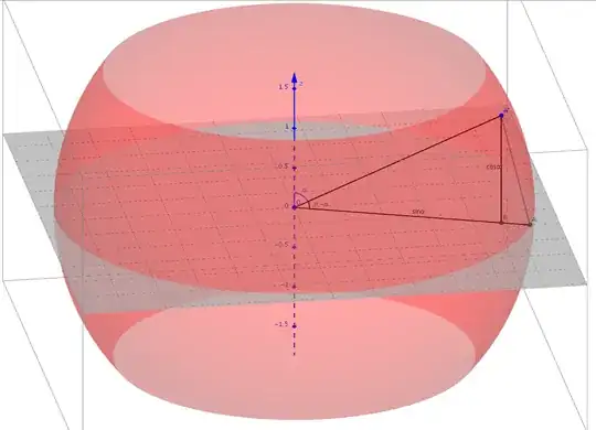

As you can see, we scale the $xy$-coordinates of the original point $A$ by $\sin{\alpha}$, and the new $z$-coordinate will be just $\cos{\alpha}$. We can do the same to rotate a point on the unit sphere like $\vec{v}$ so it forms an angle $\frac{\theta}{2}$ with the $w$-axis, scaling $\vec{v}$ by $\sin{\frac{\theta}{2}}$ and making the new $w$-coordinate, the real part, $\cos{\frac{\theta}{2}}$so the quaternion will be $\cos{\frac{\theta}{2}} + \sin{\frac{\theta}{2}}\vec{v}$.
It is $\frac{\theta}{2}$ because...
$p'=qpq^{-1}$ will be the a quaternion with real part $0$ (in 3-D space) that corresponds to the point that is the result of the specified rotation. The reason you multiply on one side by $q$ and on the the other by $q^{-1}$ is that a multiplication by just $q$ would produce a $p'$ with real part $\ne 0$, that lies outside of our 3-D space and doesn't make sense because a rotation in 3-D space should produce a point in 3-D space. Essentially by multiplying on the left by $q$ takes you out of our 3-D space and multiplying by the right by $q^{-1}$ brings you back, but with the same real part or angle of rotation each time, kind of like this diagram but 3-D rotation in 4-D space instead of 2-D rotation 3-D space:
2to3
THE ANSWER As you can see this keeps us in the plane/space we started in, but ends up doubling $\theta$ as you rotate once by $\theta$ on your way out and once by $\theta$ on your way back. So we use $\frac{\theta}{2}$ so you end up with $\theta$
