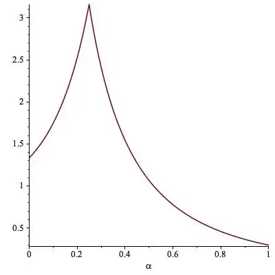

This is an extended comment to the answer of Olivier Diaz. Let $$ Hf(x):=\frac1 x\int_0^x f(y)\, dy.$$ I computed the limit $$ \ell=\lim_{A\to \infty} \frac{ \| Hf_A^\alpha\|_p^p}{\|f_A^\alpha\|_p^p}, $$ where $f_A^\alpha:=x^{-\alpha}\mathbf 1_{\{1\le x\le A\}}$, for $\alpha \in (0, 1)$.
When $\alpha<1/p$, $$ \ell=(1-\alpha)^{-p} +\frac{1-\alpha p}{(1-\alpha)(p-1)}.$$ When $\alpha >1/p$, $$ \ell=\frac{\alpha p -1}{(1-\alpha)^p}\int_1^\infty (x^{-\alpha}-x^{-1})^p\, dx.$$ When $\alpha=1/p$, as in Olivier's answer, $$ \ell=\left(\frac{p}{p-1}\right)^p.$$ The following picture shows the graph of $\ell$ as a function of $\alpha$ (for $p=4$). The peak occurs at $\alpha=0.25$, that is, $\alpha=1/p$.
Ell as a function of alpha
The fact that $\ell$ is maximal at $\alpha=1/p$ is to be expected; as Olivier shown in his answer, $f^{1/p}_A$ attains the supremum of the ratio $\|Hg\|_p/\|g\|_p$, in the limit $A\to \infty$. However, this picture also contains another, new, piece of information; it shows that $\alpha=1/p$ is the only value of $\alpha$ that attains such supremum. In other words, among all powers $x^{-\alpha}$, and in a vague sense,
$$ x^{-1/p}\text{ is the only maximizer to the Hardy inequality.}$$
See this great answer of David C. Ullrich.
