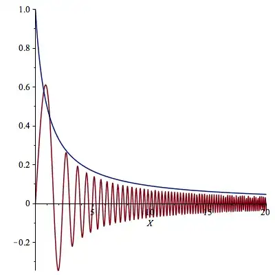

    Experimenting numerically, it seems that $\left\lvert\int_0^X[\cos(x^2)-\sin(x^2)], dx\right\rvert \le C(1+X)^{-1}$: see this plot – Giuseppe Negro Oct 31 '17 at 20:37

    This is a great answer. I think that you could prove that $I\ge 0$ and $J\ge 0$ more simply by looking at the graph of the integrand function. Starting from zero, there is a positive hump, followed by a negative one that is smaller. Then another positive hump that is bigger than the subsequent negative, and so on. Therefore the total integral must be positive. This is hand waving but can be made rigorous without much difficulty, I think. – Giuseppe Negro Nov 07 '17 at 15:02

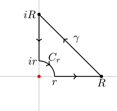

Consider the following function
$$f(z)=z^{-1/2}\,e^{iz}$$
Where we choose the principal root for $ z^{-1/2}=e^{-1/2\log(z)}$. By integrating around the following contour
enter image description here $$\int_{C_r}f(z)\,dz+\int_{r}^R f(x)\,dx+\int_{\gamma}f(z)\,dz+\int^{iR}_{ir}f(x)\,dx = 0$$
Taking the integral around the small quarter circle with $r\to 0$ $$\left| \int_{C_r}f(z)\,dz\right|\leq \left|\sqrt{r}\int^{\pi/2}_{0}e^{it/2} e^{rie^{it}}\,dt\right| \leq \sqrt{r}\int^{\pi/2}_{0}\left|e^{-r\sin(t)}\right|\,dt\sim 0$$
On $\gamma(t)=(1-t)R+iRt$ where $0\leq t \leq 1$
$$\left|\int_{\gamma}f(z)\,dz\right| = \left| R(i-1)\int^1_0e^{-1/2\log(R(1-t)+iRt)}e^{i(1-t)R-Rt}\,dt\right| \\ \leq \frac{\sqrt{2}}{\sqrt{R}} \int^1_0 \frac{e^{-Rt}}{\sqrt[4]{(1-t)^2+t^2}}\,dt$$
Hence we have
$$\left|\int_{\gamma}f(z)\,dz\right| \leq \frac{\sqrt{2}}{\sqrt{R}} \int^1_0 e^{-Rt}\,dt=\frac{\sqrt{2}}{R\sqrt{R}}\left(1-e^{-R}\right)\sim_{\infty}0$$
Finally what is remaining when $r\to 0$ and $R \to \infty$
$$\int^\infty_0 \frac{e^{ix}}{\sqrt{x}}\,dx =i \int^{\infty}_{0}(ix)^{-1/2}e^{-x}\,dx$$
Note that $i^{-1/2}=e^{-i\pi/4}$
$$\int^\infty_0\frac{e^{ix}}{\sqrt{x}}\,dx = ie^{-i\pi/4}I = \frac{I}{\sqrt{2}}+i\frac{I}{\sqrt{2}}$$
By equating the real part with the real part and the imaginary part with the imaginary part we reach $$\int^\infty_0\frac{\cos(x)}{\sqrt{x}}\,dx =\int^\infty_0\frac{\sin(x)}{\sqrt{x}}\,dx = \frac{I}{\sqrt{2}} $$
Although $I$ is easy to evaluate using the gamma function, we didn't have to evaluate it to show equivalence.
