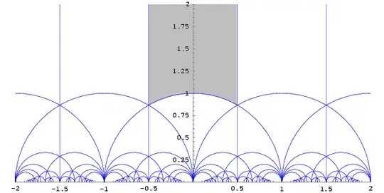

You can write down an argument in which one factor of $\pi$ comes from the area of a circle, and the other one comes from the area of the fundamental region in the hyperbolic plane.
The quick summary is that picking a unimodular lattice uniformly at random in $\mathbb R^2$ puts an expected number of $\pi r^2$ nonzero lattice points in the disk of radius $r$, and an expected number of $6/\pi\, r^2$ primitive lattice points in that disk. Nonzero lattice points are $\zeta(2)$ times as common as primitive lattice points, so $6/\pi\,\zeta(2) = \pi$.
Random unimodular lattices
A lattice in $\mathbb R^2$ is a set of the form $\Lambda = \{a v + b w; a, b \in \mathbb Z\}$, where $v$ and $w$ are linearly independent vectors in $\mathbb R^2$. A lattice is unimodular if the vectors you start with span a parallelogram of area 1. Equivalently, a unimodular lattice in $\mathbb R^2$ is an image under some element of $\mathop{SL}(2,\mathbb R)$ of the rectangular lattice $\mathbb Z^2$.
We want to say what it means to pick a random unimodular lattice, so we'd like to parametrize all unimodular lattices, modulo rotation. Starting with a unimodular lattice, we can rotate it so that one of its generating vectors lies on the $x$ axis. Then it is spanned by vectors of the form $t^{-1/2} (1,0)$ and $t^{-1/2} (s,t)$ with $t>0$. It's traditional to use the complex number $z = s + t i$ in the upper half plane to represent this lattice. However, the representation isn't unique: $z = 2i$ represents the same lattice modulo rotation as $1+2i$ and $i/2$ and so on. But you can always pick the shortest vector in the lattice as the first basis vector and the next shortest (independent) vector as the other one. If you do this, every unimodular lattice in $\mathbb R^2$ modulo rotation corresponds to exactly one complex number in the fundamental region pictured below.
fundamental region
We want an appropriate way to pick random elements of this set, so we want a notion of "area" in the fundamental region. It turns out that the right notion comes from thinking of the upper half plane as a model of hyperbolic geometry. The hyperbolic area of a small $ds$ by $dt$ rectangle at $(s,t)$ is $t^{-2} ds\, dt$. The reason this is the right way to measure area is that it's preserved by the action of $\mathop{SL}(2,\mathbb R)$ on the upper half plane, which means the corresponding distribution on unimodular lattices will be also be invariant under the action of $\mathop{SL}(2, \mathbb R)$.
So we pick a random unimodular lattice in $\mathop{SL}(2, \mathbb R)$ by picking a random element of the fundamental region, taking the corresponding lattice in $\mathbb R^2$, and rotating it by a random amount.
We can compute the area of the fundamental region using a double integral:
$$A = \int_{-1/2}^{1/2} \int_{\sqrt{1-s^2}}^\infty t^{-2}\, dt\, ds = \frac \pi 3.$$
(This is the most mysterious place that $\pi$ appears in this argument. To better explain its presence, you can give an alternate proof that $A = \pi/3$ by noting that the fundamental region is a hyperbolic triangle whose angles add up to $\pi - \pi/3$. Hyperbolic geometry is a lot like spherical geometry, but with curvature -1 instead of curvature 1. If you're comfortable with how $\pi$ appears in areas of triangles in spherical geometry, it's natural to expect it to play a similar role in hyperbolic geometry.)

But you can compute the same expectation in a more straightforward way. Heuristically, generating a random unimodular lattice boils down to starting with $\mathbb Z^2$ in $\mathbb R^2$ and applying random elements of $\mathop{SL}(2, \mathbb R)$ to it. This smears out the nonzero lattice points uniformly over all of $\mathbb R^2$. And since the points of the original lattice had density 1, this uniform smear also has density 1, so the expected number of nonzero lattice points that land in a given set is precisely the area of that set.
More formally, consider the measure $\mu$ on $\mathbb R^2$ given by $\mu(S) = \mathop{\mathbb E}\left( \left| S \cap \Lambda \mathord\setminus \{0\} \right| \right)$, where we average over all unimodular lattices $\Lambda$. Because the distribution on $\Lambda$ is invariant under the action of $\mathop{SL}(2,\mathbb R)$, the measure $\mu$ is also invariant under that action. That means it must be some multiple of the usual Lebesgue measure, except possibly a singularity at the origin. You can check that there's no singularity, and check that the multiple must be $1$ by considering something like the limit of $r^{-2} \left| B_r \cap \Lambda \mathord\setminus \{0\} \right|$ as $r \to \infty$ for each fixed $\Lambda$. So $\mu$ is the usual Lebesgue measure and
$$ \mathop{\mathbb E}\left( \left| B_r \cap \Lambda\mathord\setminus \{0\} \right| \right) = \mu(B_r) = \pi r^2. $$
Comparing this to the previous expression, we have $2\zeta(2)/A = \pi$ and hence
$$ \zeta(2) = \frac{A}{2} \pi = \frac{\pi^2}{6}. $$
