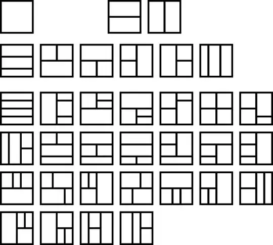

I had my student, Tim Michaels, work on this. We came up with a complicated recurrence relation, indicated below. The first few answers are 1, 2, 6, 25, 128, 758, 5014, 36194, 280433, 2303918, 19885534, 179028087, 1671644720, 16114138846, 159761516110, 1623972412726, 16880442523007, 179026930243822, 1933537655138482, 21231023519199575, 236674460790503286, 2675162663681345170, 30625903703241927542, 354767977792683552908, 4154708768196322925749, 49152046198035152483150, 587011110939295781585102, 7072674305834582713614923. Note that we are counting rotations and reflections as distinct tilings. An interesting pattern is that mod 2, there is an 8-fold periodicity which we don't understand and can't prove in general.
Here's a picture of the cases n=1,2,3,4, with 1,2,6,25 tilings in each case.The way to systematically generate these is to "push in" a vertical line from the right to all previously constructed tilings in all possible ways. That's how the recurrence relation is defined.
alt text

  • By the way, the recurrence involved counting tilings with a specific number of edges hitting the right side of the square and a specific number of places where 4 rectangles meet in a vertex. – Cheerful Parsnip Oct 31 '10 at 14:56
  • 1, 2, 6, 15 are exactly the numbers I have when I count by hands (including all rotations and reflections.) I will appreciate if you can share the recurrence relation or point me to a publication. – puri Nov 02 '10 at 00:10
  • I've added a picture to show there are indeed 25 tilings with 4 rectangles. – Cheerful Parsnip Nov 02 '10 at 09:18
  • Okay now I've added the recurrence relation! – Cheerful Parsnip Nov 02 '10 at 09:29
  • @Jim Conant: On the third iteration, aren't the four last figures redundant since they are just rotations of the first two? By the way, your picture is so annoying to look at, I'm prey of the grid illusion! :D – Raskolnikov Feb 18 '11 at 15:52
  • @Raskolnikov: Yes the grid illusion is pronounced. :) To answer your question, the list includes rotations and reflections as distinct. I haven't tried figuring out a formula once you mod out by dihedral symmetries, but I bet it is even more complicated. – Cheerful Parsnip Feb 18 '11 at 16:43
  • @Jim Conant: I can't tell from your picture what definition of "distinct tilings" you are using, because there is a question that first arises for five tiles. Look at the center tiling in the second row of your four-tile collection. How many distinct tilings can be formed by adding a single vertical edge to its topmost rectangle? Is it three, or just one (and what does your recurrence relation say)? – mjqxxxx Feb 20 '11 at 00:50
  • @mjqxxxx: If I understand you correctly, there would be three possible new tilings. One where the new edge is above the left part, one where it creates a 4-valent vertex, and one where it is above the right part. The definition of combinatorially equivalent could be phrased to say that there is a homeomorphism from one tiling to the other that is the identity on the 4 corners. (Or something.) I realize that I haven't explained the recurrence relation very well. Tim and I should really write this up into a paper. – Cheerful Parsnip Feb 20 '11 at 01:51
  • @mjqxxxx: But to explain a little bit, the recurrence relation counts the number of ways of pushing an edge in from the right, so that in any particular tiling, to see what tiling it "comes from," you take a right-most vertical line segment and push it off the right side. There is a problem with this, though. There could be many "right-most" line segments, so there is overcounting. This is the role of the outside alternating summation. It is really an inclusion-exclusion in disguise, and accounts for overcounting. – Cheerful Parsnip Feb 20 '11 at 01:53
  • @Jim Conant: Actually I was asking about the fourth tiling in the second row, where adding a vertical edge to the topmost rectangle can't form a 4-valent vertex. From your explanation I assume there is only one way to do that? – mjqxxxx Feb 21 '11 at 19:00
  • @mjqxxxx: Indeed. – Cheerful Parsnip Feb 21 '11 at 19:21
  • I've edited the post to include a link to a paper that described this in more detail. – Cheerful Parsnip Feb 22 '11 at 20:06
  • In the n=4 case, where is the tiling which is just 3 vertical cuts, i.e. 4 long vertical rectangles, i.e. 90-degree rotation of the first solution in n=4? Am I missing something? – antkam May 22 '18 at 13:40
  • @antkam: Well-spotted! I accidentally omitted that one and duplicated the last one and the 8th one in the list of $n=4$. – Cheerful Parsnip May 22 '18 at 14:56
