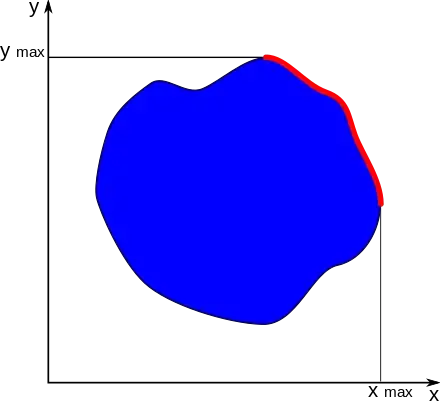

Point 2 can be expanded to other classification settings: in a typical data science project you might find a multi-class classification setting where simple 1 dimensional threshold tuning will not work anymore to improve the precision/recall tradeoff for all classes equally. (And you might have to make this tradeoff due to a high cost imbalance)
How can you solve these multi target optimizations from point 2? You could use oversampling/downsampling/weighting as an indirect way to find different Pareto optimal points. Given different fractions of targets in up- or downsampling you will achieve different values of precision and recall and will move on the Pareto front.red Pareto front (bigger is better) with x axis e.g. recall and y axis precision. Since there is no total order (but only the Pareto order https://en.m.wikipedia.org/w/index.php?title=Pareto_order) you cannot decide which point on the Pareto front is better, image by Berklas under CC-by SA (red Pareto front (bigger is better) with x axis e.g. recall and y axis precision. Since there is no total order (but only the Pareto order https://en.m.wikipedia.org/w/index.php?title=Pareto_order) you cannot decide which point on the Pareto front is better, image by Berklas under CC-by SA)
Ways to find a Pareto optimal solution while avoiding to fudge with the class frequencies by upsampling or downsampling:
  • The draft https://arxiv.org/abs/2201.08528v3 ("To SMOTE or not to SMOTE?") shows that for binary classification threshold-tuning is equally good to up or down sampling in strong learners (XGboost etc) and maintains calibration.
  • With an explicit cost assignment you can alternatively do cost-sensitive machine learning and get class assignments which are cost-optimal. This scalarization with a cost function is a more explicit way to deal with the fact that in a multi-objective optimization (detecting multiple classes optimally) there is multiple incomparable Pareto optimal solutions.
