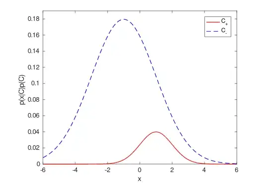

In cases where there is a substantial difference in relative class frequencies, it could be that the density of the minority class is never higher than the density of the majority class anywhere in the attribute space. Here is a simple example using univariate Gaussian classes, with an imbalance ratio of 1:9.
In this case, if my classifier assigns all patterns to the majority class, it is doing exactly the right thing, and there is no problem to solve.
In this case, we know the true data generating process, so we know that the classifier is doing the right thing. However in general we don't know the true distributions of positive and negative classes, so we don't know whether the classifier is doing the right thing or not.
