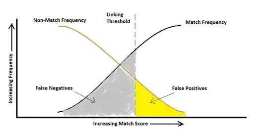

In practice you may sacrifice an error to optimize the other one. For instance diagnosis of HIV might be a case (I am just mocking-up an example). It is highly imbalanced classification as, of course, the number of people with no HIV is dramatically higher than the ones who are carrier. Now let's look at errors:
False Positive: Person does not have HIV but test says they have.
False Negative: Person does have HIV but test says they don't.
If we assume that wrongly telling someone that he got HIV simply leads to another test, we may take much care about not wrongly say someone he is not a carrier as it may result in propagating the virus. Here your algorithm should be sensitive on False Negative and punishes it much more than False Positive i.e. according to the figure above, you may end up with higher rate of False Positive.
Same happens when you want to automatically recognize people faces with a camera to let them enter in an ultra-security site. You don't mind if the door is not opened once for someone who has permission (False Negative) but I'm sure you don't want to let a stranger in! (False Positive)
