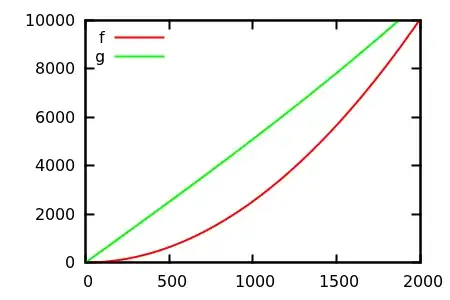

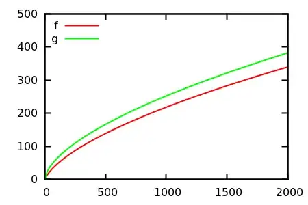

Over here, Dave Clarke proposed that in order to compare asymptotic growth you should plot the functions at hand. As a theoretically inclined computer scientist, I call(ed) this vodoo as a plot is never proof. On second thought, I have to agree that this is a very useful approach that is even sometimes underused; a plot is an efficient way to get first ideas, and sometimes that is all you need.
When teaching TCS, there is always the student who asks: "What do I need formal proof for if I can just do X which always works?" It is up to his teacher(s) to point out and illustrate the fallacy. There is a brilliant set of examples of apparent patterns that eventually fail over at math.SE, but those are fairly mathematical scenarios.
So, how do you fool the plot inspection heuristic? There are some cases where differences are hard to tell appart, e.g.
example example example
[source]
Make a guess, and then check the source for the real functions. But those are not as spectacular as I would hope for, in particular because the real relations are easy to spot from the functions alone, even for a beginner.
Are there examples of (relative) asymptotic growth where the truth is not obvious from the function definiton and plot inspection for reasonably large $n$ gives you a completely wrong idea? Mathematical functions and real data sets (e.g. runtime of a specific algorithm) are both welcome; please refrain from piecewise defined functions, though.

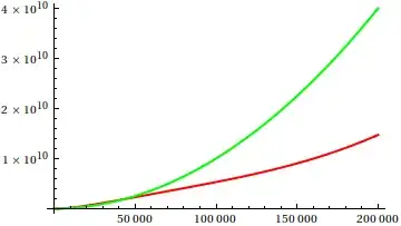

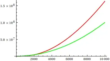

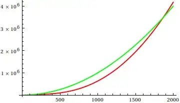

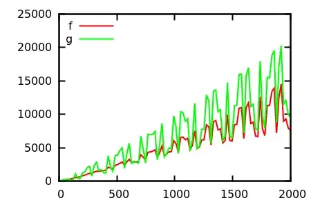

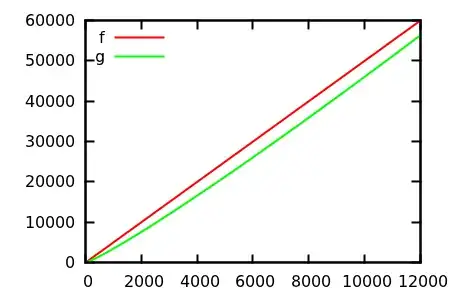

Here is another (admittedly rather constructed) example, but still one I find remarkable. It is intended to show that plots can be very misleading for judging asymptotic growth.
The following plots show two functions $f$ and $g$ — disclosed below ;) — in different ranges. Remarkably, both functions are monotonically (strictly) increasing, (infinitely often) continuous differentiable and convex, so they are “nice” in many respects.
Can you guess which of the functions grows (asymptotically) faster?
plot of f and g up to 2000 plot of f and g up to 10,000 plot of f and g up to 200,000
The answer: $f\sim g$, i.e. the functions are asymptotically equivalent. The functions are $$f(x) = x^2$$ $$ g(x) = \iint \sin(\log(x))+1 \;dx\,dx = x^2\Bigl(1 - \tfrac{3}{5} \cos(\log(x)) + \tfrac{1}{5} \sin(\log(x)) \Bigr)\;. $$
So $g$ is essentially $x^2$, i.e. the same as $f$, but its second derivative is not uniformly $2$, but oscillates between $0$ and $4$ with exponentially growing period. This oscillation is not visible in ordinary plots.

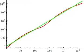

For this example, we can demask the oscillations by considering a log-log-plot:
log-log-plot of f and g up to 200,000
Of course, this does not help, in general; for example, we might have a doubly exponential period ...

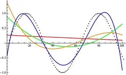

8
The mathematical technique of curve fitting can be used to provide an infinite number of answers to your question. Given a curve and a range, one can readily find a polynomial that fits the curve to any degree of accuracy. This example from wikipedia shows how a sin wave can be fairly accurately fitted with a forth order polynomial (the blue curve).
I could use higher order polynomials, and fool the plot inspection heuristic even better than this graph does.
