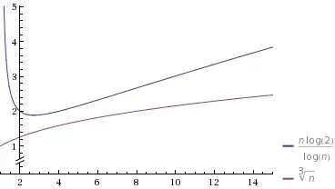

If you just draw a couple of graphs, you'll be in good shape. Wolfram Alpha is a great resource for these kinds of investigations:
equations
Graph
Generated by this link. Note that in the graph, log(x) is the natural logarithm, which is the reason the one graph's equation looks a little funny.

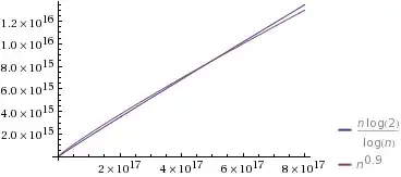

Let us plot a particular case on a graph
Source: Wolfram Alpha
I selected O(n^k) such that k is quite close to 1 (at 0.9). I also selected the constants so that initially O(n^k) is slower. However, notice that it eventually "wins" in the end, and takes less time than O(n/log n).
