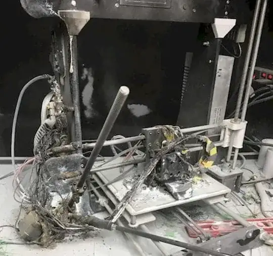

To illustrate the point: This happens if Thermal Runaway Protection is disabled, and the associated story. Luckily this one did not result in a loss of life and home, but it could have - and the owner was able to do some forensic examination on what caused the fire.
Anet A8 that has caught fire
