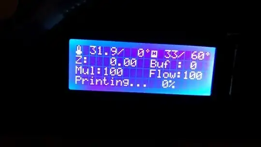

I don't understand what's wrong with my G-code. I have set the printing temperature to 195 °C but when I try to print, the target temperature is always 0 °C and printing never starts.
I have tried changing material preset to different PLA profiles but that didn't help at all.

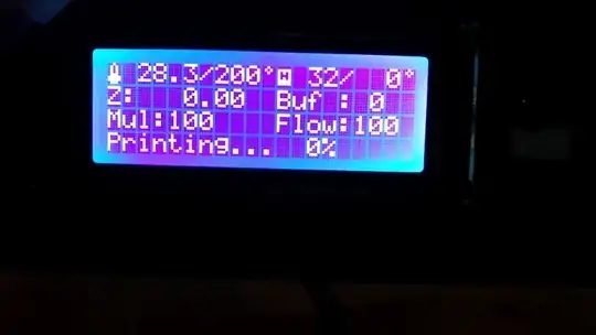

In addition, the extruder and heat sensor are working. An older G-code file correctly sets 200 °C as the target temperature for the extruder.
This G-code prints just fine

I got the same problem today and after a lot of troubleshooting (following the answers here) I found out that the issue was the connection to the hotbed. After I clean out the connection to the hotbed the printer started working as usual. The debugging logic was that the printer heats up the hotbed before setting the extruder temperature.
Looking to your LCD the issue seems to be the same, since 33 degrees is a normal ambient temperature.
