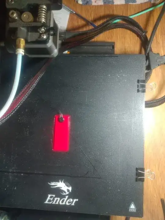

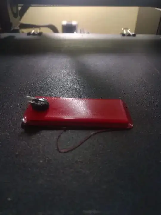

Additional information:
After serveral tries I came up to this code which lead to the results shown in the pictures. Why is this happening?

The results:
PS: I am trying to print some text. Sorry I didn't realize to tell before.
