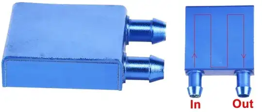

What I am getting to is a device like this:
e
It is the perfect size for a stepper motor. My plan is to zip-tie one of these to each stepper motor and water cool it in a single path across my printer, including the hot end.

The only thing I would worry about is the surface area inside this particular style of block, and ensuring that you use an all-aluminum radiator since the block is aluminum.
There is another type of cheap 40x40 aluminum block with the nipples on the face instead of on the edge. That style has fins and a lot of surface area inside. This style with the nipples on the edge has a big S channel inside and not much surface area. It may still be more than enough. I'm just saying it's a significant difference and it might make a difference. If you find you're not cooling enough, all you may need to do is switch to that other style of block, not try to install 3 blocks per motor or any other exotic nonsense.

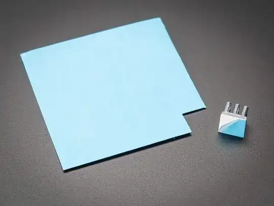

Your solution will not cool all sides effectively. Firstly don't use zip ties; get thermal tape.
Thermal Tape (https://www.amazon.com/Thermal-Interface-Products-Heat-Sink/dp/B00QSHPH8E/
Secondly, the heat will need to travel around the outside of the motor to get from the side that doesn't have the water block. Its expensive but you could use Pyrolytic Graphite Sheets to wrap around the outside of the motor, to get the heat to the water block faster.

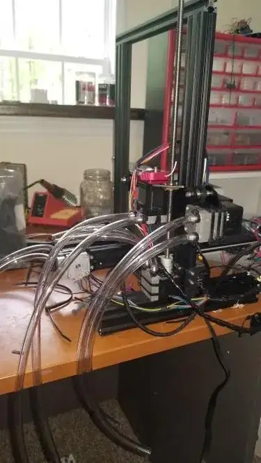

I just did this lol and checked online to see if anyone else did it too. It works really nice.
I used thermal paste and zipties to secure each block to the stepper motor. Dont use thermal tape its not as effective as paste.
I had to do this operations since my motors were overheating due to the enclosure design.
