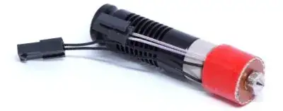

Let's suppose I want to build a water block shaped exactly for my Ubis 13s hot end
Ubis 13 hot end
(similar to this instructable), or that I want to circulate water around specific objects to be cooled (like Water-cooling stepper motor with aluminum block).
