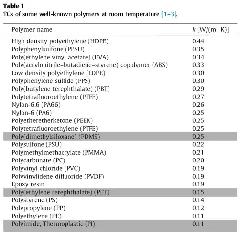

To get a good picture which plastics are useful in such an application (like mentioned in question: "Water-cooling stepper motor with aluminum block"), I need to know what is the thermal conductivity of the commonly used thermoplastics.

All values are in W/(m*K).
  • PLA: 0.13
  • HIPS: 0.20
  • ABS: 0.25
  • PETG: 0.29
  • PEEK: 0.25
  • PLA with copper: 0.25 (see discussion)

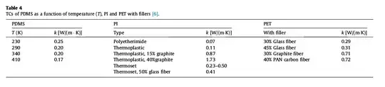

  • PETG with 40% graphite: 1.70 (ansiotropic)
  • TCPoly: 15
  • Steel (not a 3dprintable plastic): 10 - 50
