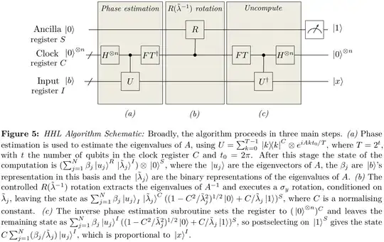

Names and symbols used in this answer follow the ones defined in Quantum linear systems algorithms: a primer (Dervovic, Herbster, Mountney, Severini, Usher & Wossnig, 2018). A recall is done below.
1.1 Register names
Register names are defined in Figure 5. of Quantum linear systems algorithms: a primer (Dervovic, Herbster, Mountney, Severini, Usher & Wossnig, 2018) (reproduced below):
  • $S$ (1 qubit) is the ancilla register used to check if the output is valid or not.
  • $C$ ($n$ qubits) is the clock register, i.e. the register used to estimate the eigenvalues of the hamiltonian with quantum phase estimation (QPE).
  • $I$ ($m$ qubits) is the register storing the right-hand side of the equation $Ax = b$. It stores $x$, the result of the equation, when $S$ is measured to be $\left|1\right>$ at the end of the algorithm.
HHL algorithm

As said in the previous part, $\left|\Psi_0\right>$ is an initial state. They do not prepare $\left|\Psi_0\right>$ after the phase estimation procedure. The sentence ordering is not really optimal in the paper. The phase estimation procedure they use in the paper is a little bit different from the "classic" phase estimation algorithm represented in the quantum circuit linked in part 1, and that is why they explain it in details.
Their phase estimation algorithm is:
  1. Prepare the $\left|\Psi_0\right>$ state in the register $C$.
  2. Apply the conditional Hamiltonian evolution to the registers $C$ and $I$ (which are in the state $\left|\Psi_0\right>\otimes \left|b\right>$).
  3. Apply the quantum Fourier transform to the resulting state.
Finally, the $C$ in $\left| \Psi_0 \right>^C$ means that the state $\left| \Psi_0 \right>$ is stored in the register $C$. This is a short and convenient notation to keep track of the registers used.

$\sum_{\tau = 0}^{T-1}|\tau\rangle \langle \tau|^{C}\otimes e^{iA\tau t_0/T}$ is the mathematical representation of a quantum gate.
The first part in the sum $|\tau\rangle \langle \tau|^{C}$ is a control part. It means that the operation will be controlled by the state of the first quantum register (the register $C$ as the exponent tells us).
The second part is the "Hamiltonian simulation" gate, i.e. a quantum gate that will apply the unitary matrix given by $e^{iA\tau t_0/T}$ to the second register (the register $I$ that is in the initial state $\left|b\right>$).
The whole sum is the mathematical representation of the controlled-U operation in the quantum circuit of "1. Definitions", with $U = e^{iA\tau t_0/T}$.
