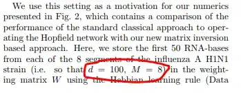

However, in this[$\dagger\dagger$] paper on page 6 they claim that they used the HHL09 algorithm to estimate the pseudoinverse of $A$ which of size ~$200\times 200$. In that paper, $A$ is defined as:
$$A := \begin{pmatrix} W - \gamma \Bbb I_d & P \\ P & 0 \end{pmatrix}$$
where $P$,$W$ and $\Bbb I_d$ are all $d\times d$ matrices.
In the H1N1 related simulated Lloyd et al. have claimed to have made, $d = 100$. And they further claim that they used the HHL09 algorithm to estimate the pseudo-inverse of $A$ (which is of size $200\times 200$). That would need a minimum of $7\lceil{\log_2(200)\rceil}+1 = 7(8)+1 = 57$ qubits to simulate. I have no idea how they could possibly do that using the current quantum computers or quantum computer simulations. As far as I know, IBM Q Experience at present supports ~$15$ qubits (that too it isn't as versatile as their $5$-qubit version).
Am I missing something here? Does this Step 1 actually require a lesser number of qubits than what I have estimated?

Calculation of the inverse of an $N\times N$ matrix can be done by applying HHL with $N$ different $\vec{b}_i$ (specifically, HHL is applied $N$ times, once for each computational basis vector used as the $\vec{b}_i$).
In each case, phase estimation has to be done for an $N \times N$ matrix.
The number of qubits required for phase estimation is written on page 249 of the 10th anniversary edition of N&C:
"The quantum phase estimation procedure uses two registers. The first register contains $t$ qubits."
"The second register [...] contains as many qubits as is necessary to store $|u\rangle$", where $|u\rangle$ is an $N$-dimensional vector.
So you are correct that we would need $6$ qubits for the first register, and $\log N=8$ qubits for the second register.
This is 14 qubits in total to do the phase esitmation part of each HHL iteration involved in calculating the inverse of a matrix. 14 qubits is well within the capabilities of a laptop.
