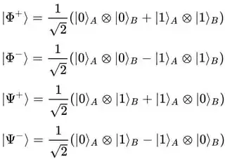

Here below you see the definition of the 4 Bell states.
The 4 bell states

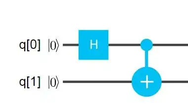

The first bell state can be easily implemented on the composer through a Hadamard gate and a CNOT gate as follows:
first Bell state

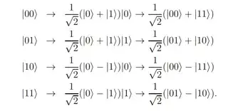

Remember that the Hadamard (H) gate maps $|0\rangle$ to $\frac{|0\rangle+|1\rangle}{\sqrt{2}}$ and $|1\rangle$ to $\frac{|0\rangle-|1\rangle}{\sqrt{2}}$, while the CNOT gate has the following conversion table:
So, you can use the same circuit:
but begin in the states $|01\rangle$, $|10\rangle$ and $|11\rangle$ to get the other three Bell states (you can easily convert to these states from $|00\rangle$ using the Pauli-X gate).

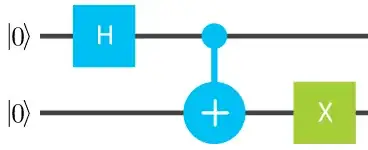

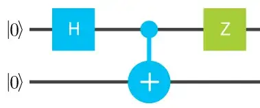

So here is $|\Phi^-\rangle$:

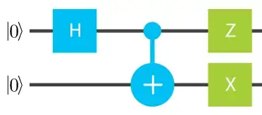

And here is $|\Psi^-\rangle$:
