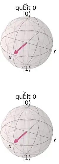

Speaking in terms of simulations using qiskit, the following code yelds the same results:
circuit = QuantumCircuit(1)
circuit.h(0)
state = Statevector.from_instruction(circuit)
display(plot_bloch_multivector(state, title="H", reverse_bits=False))
circuit = QuantumCircuit(1) circuit.ry(0.5*np.pi,0) state = Statevector.from_instruction(circuit) display(plot_bloch_multivector(state, title="Y", reverse_bits=False))

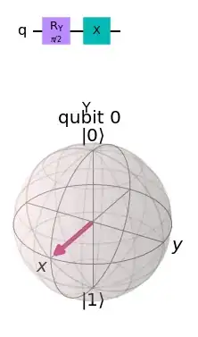

While Hadamard gate is defined as $$ H= \frac{1}{\sqrt{2}} \begin{pmatrix} 1 & 1 \\ 1 & -1 \end{pmatrix}, $$ $y$-rotation by $\pi/2$ leads to gate $$ Ry(\pi/2)= \frac{1}{\sqrt{2}} \begin{pmatrix} 1 & -1 \\ 1 & 1 \end{pmatrix}. $$ So, there is a difference in position of -1 in the second column. Application of the $X$ gate returns the -1 in $Ry(\pi/2)$ to right place to obtain Hadamard gate.
You can easily see that $H|0\rangle = \frac{1}{\sqrt{2}}(|0\rangle + |1\rangle)$ and $Ry(\pi/2)|0\rangle = \frac{1}{\sqrt{2}}(|0\rangle + |1\rangle)$. Application of $X$ after $Ry$ leads to the same quantum state.
However, while $H|1\rangle = \frac{1}{\sqrt{2}}(|0\rangle - |1\rangle)$, $Ry(\pi/2)|1\rangle = \frac{1}{\sqrt{2}}(-|0\rangle + |1\rangle)$. Application of $X$ after $Ry$ switches states $|0\rangle$ and $|1\rangle$ and leads to $XRy(\pi/2)|1\rangle = \frac{1}{\sqrt{2}}(|0\rangle - |1\rangle)$.
This all means that $XRy(\pi/2)=H$.

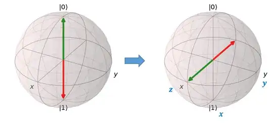

A more intuitive approach is to examine the effect of the rotations on the Bloch sphere. Note that the H gate is a rotation about an axis which is on the X-Z plane, in the middle between the X and Z axes, as shown:

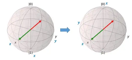

When we perform a 90° rotation about the Y axis, $R_y\left(\frac{\pi}{2}\right)$:
We seem to have the correct result, namely $|0\rangle\rightarrow|+\rangle,|1\rangle\rightarrow|-\rangle$.
However, on closer inspection, we see that the original x axis is now pointing "down", whereas the H gate results in the x axis pointing up ($|+\rangle$ changing places with $|0\rangle$).
Moreover, if we apply $R_y\left(\frac{\pi}{2}\right)$ again, we get the wrong result: $|+\rangle \rightarrow |1\rangle$ instead of $|0\rangle$, and $|-\rangle \rightarrow |0\rangle$ instead of $|1\rangle$
Adding a $\pi$ rotation about the X axis, $R_x\left(\pi\right)=X$, "fixes" the resulting location of the X axis (pointing "up"), making the resulting operation correct (no effect on the $|+\rangle,|-\rangle$ states which are on the X axis, and flipping the $|0\rangle, |1\rangle$ states)
