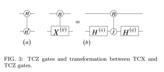

Based on the paper Elementary gates of ternary quantum logic circuit, the extensions of the Z gate are as follows
$$ \begin{gather} Z^{[0]} = \text{diag}\{-1, I_2\} = \begin{bmatrix} -1 & 0 & 0 \\ 0 & 1 & 0 \\ 0 & 0 & 1 \end{bmatrix} \\ Z^{[1]} = \text{diag}\{1, -1, 1\} = \begin{bmatrix} 1 & 0 & 0 \\ 0 & -1 & 0 \\ 0 & 0 & 1 \end{bmatrix} \\ Z^{[2]} = \text{diag}\{I_2,-1\} = \begin{bmatrix} 1 & 0 & 0 \\ 0 & 1 & 0 \\ 0 & 0 & -1 \end{bmatrix} \end{gather} $$
The controlled variant, denoted $TCZ$, is defined as the gate that implements $Z^{[n']}$ on the target qutrit iff the control qutrit is in the state $|n\rangle$ where $n\in\{0, 1, 2\}$. Figure 3 (a) below gives the circuit representation of the $TCZ$ gate.
