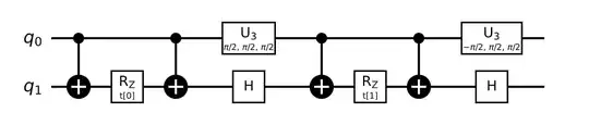

So we know that $e^{i t H_2}$ has the following circuit:
From this answer along with page 13 from this paper we can try to build the controlled-version of $e^{i t H_2}$ as follow:
