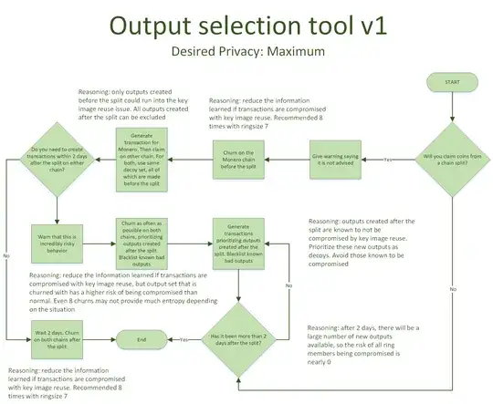

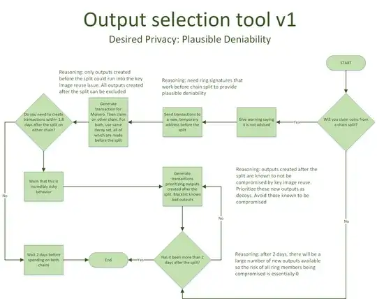

I've created a high-level guide below on how to handle chain splits. Many of the actions can be taken with the steps listed in the other comment. Keep in mind that even if you do make transactions without claiming a chain split, you should commit to it. If you have even the slightest desire to claim these coins (suppose they peak in value later), then you will want to use the key-reuse-mitigation2 option. Using this option will reduce your privacy compared to what is the theoretical best, but it allows for greater flexibility.
Chain split plausible deniability
Chain split maximum
  1. Don't claim coins in fork
This is absolutely true. The best way to protect you and the network is to avoid chain splits completely. Even with precautions and special tools, you will be better off not claiming funds.
  1. Churn after fork
I'll talk more broadly about churning and how it could mitigate the risks of chain splits.
In general, you churn to increase the anonymity set of your transactions without choosing an unusual ringsize. For the sake of chain splits, you can churn before and after the split to make the key image association essentially meaningless: no one can tell what happens before or after the transaction even if the transaction is compromised.
It is difficult to estimate the exact benefit of churning before the split since the proportion of to-be compromised UTXOs are unknown. If many people claim the funds, then this could pose a problem. With ringsize 7, the recommended number of churns is 8.
Churning after the fork is also though. It is uncertain how many of the decoys will be compromised. It is possible that the anonymity set increased through churning will be much smaller than the number of decoys referenced, since many of these decoys could be known to be false.
Churning within 2 days of the chain split has a high probability of decoys being compromised. While it is unlikely that churning in this situation will reduce your privacy, it will likely have limited or nearly no benefits. As you can see in the guide, I strongly recommend waiting at least 2 days after the split to churn if that is your desire. Even 2 days after, it is possible for the churns to be less effective. You could churn 12 times after the two day waiting period to be sure that it has the same protection even if half the decoys in each of these transactions are compromised.
Keep in mind that churning places stress on the network. It is not realistic for everyone to churn. I only reference it for extreme situations. If you do not have an extreme situation, you are likely fine with the steps outlined in the plausible deniability guide.
Also note that most people recommend churning with the current minimum, or at least most-used, ringsize. At the time of the first chain split, this number is 7.
  1. Any non-technical measures e.g. redirect newcomers interested in the forked coin to original Monero; discourage exchanges to list fork coin...
This is a social threat, since it only becomes one under certain actions. If many people claim the funds, then it will have a larger impact (especially within the first 2 days after). If no one claims the funds, then the impact will be essentially zero. However, keep in mind there is the potential for significant impact within these first few days. Whether it is realized is something that will need to be seen.
Final Thoughts
The guides I linked and the tools user36303 referenced only work if you are permitted to use the same ringsize and ring member set on the split. This is not always the case. Suppose I forked "MoneroLight" with mandatory ringsize 1 (0-mixin) transactions. These tools provide no protections when claiming these funds, since there are no decoys. In such a scenario, the only way to stay safe is to not claim the funds. Churning aggressively before and after the split may mitigate the damage to you, but the damage will already be done to the network.
Also, churning is not very well researched. Be careful of timing attacks, IP address attacks, and other considerations that will reduce the effectiveness of churning in practice. Churning is unlikely a magic bullet that solves all the problems, though it likely still provides more benefits than harms. Please wait further research before seeing if churning is actually beneficial.
