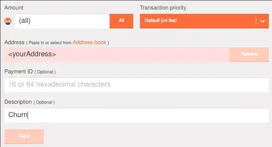

To do it with the CLI wallet, simply command sweep_all <yourAddress>.
To do it with the GUI wallet, click on the All button to select entire balance, copy your address to the Address field field and click the Send button.
