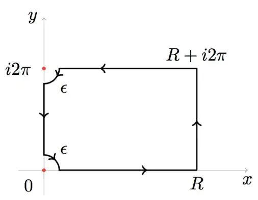

28
To solve the integral I thought of a rectangle of vertices $0$, $R$, $R+i2\pi $ and $i2\pi$. Since the function we are going to use is singular in $i2k\pi $ we have to indent the first and the last vertex by using a quarter of circle for each one: let's make them small, of radius $\epsilon$.
Calling this contour $\Gamma$ we have:
$$ \oint_{\Gamma} \frac{z^4}{e^z -1}\mathrm{d}x = 0 $$ by Cauchy's theorem.
As you will notice we have by now 4 segments and 2 quarters of circle to integrate on, namely: $$ \int_\epsilon ^R \frac{x^4}{e^x - 1}\mathrm{d}x + \int_0 ^{2\pi} \frac{(R+iy)^4}{e^{R+iy}- 1}i\mathrm{d}y + \int_{R}^\epsilon \frac{(x+i2\pi)^4}{e^{x+i2\pi}-1}\mathrm{d}x + \int_0 ^{-\frac{\pi}{2}}\frac{(2 \pi i + \epsilon e^{i\theta})^4}{e^{2\pi i + \epsilon e^{i\theta}}-1} i\epsilon e^{i\theta}\mathrm{d}\theta + \int_{2\pi- \epsilon}^{\epsilon}\frac{(iy)^4}{e^{iy}-1}i\mathrm{d}y+ \int_{\frac{\pi}{2}}^{0}\frac{(\epsilon e^{i\theta})^4}{e^{\epsilon e^{i\theta}}-1}i\epsilon e^{i\theta} \mathrm{d}\theta = 0. $$
We can first expand the power in the third integral and note that its first term cancels out with the first integral.
Before writing anything else we take into account the limits $R \to +\infty$, which cancels out the second integral, and $\epsilon \to 0^+$, which annuls the last one and yields a finite value $-8i\pi^5$ in the 4th one.
Therefore we get $$ -i8\pi \int_0 ^\infty \frac{x^3}{e^x - 1} \mathrm{d}x + 24\pi^2\int_0 ^\infty \frac{x^2}{e^x -1}\mathrm{d}x + i 32 \pi^3 \int_0 ^\infty \frac{x}{e^x - 1}\mathrm{d}x- 16\pi^4\int_0 ^\infty \frac{1}{e^x - 1}\mathrm{d}x -i8\pi^5+\frac{i}{2} \int_0 ^{2\pi} y^4 \mathrm{d}y - \frac{1}{2} \int_0 ^{2\pi} \frac{y^4 \sin y}{1-\cos y}\mathrm{d}y=0. $$ Where we have split the 5th integral into its real and imaginary parts.
By considering the expression of the imaginary parts only: $$ -8\pi \int_0 ^\infty \frac{x^3}{e^x - 1} \mathrm{d}x + 32\pi^3 \int_0 ^\infty \frac{x}{e^x - 1}\mathrm{d}x - 8\pi^5 + \frac{16}{5}\pi^5 = 0. $$
The second integral gives $\frac{\pi^2}{6}$ (for a solution of this one a contour similar to the one we've used here is needed; I'm pretty sure it has already been solved here on Math.SE).
Finally: $$ \int_0 ^\infty \frac{x^3}{e^x - 1} \mathrm{d}x = \frac{\pi^4}{8} \left(\frac{16}{3}-8+\frac{16}{5}\right) = \frac{\pi^4}{15}. $$

entrelac
  • 4,781
  • I'm sorry, but isn't the half circular bend around the origin unnecessary? The indent/outdent should be where the poles happen to be (i.e., where you use the residue formula), I think. Furthermore, shifting the contour of $i\pi$ plus using $-e^z=e^{z+i\pi}$ in the denominator doesn't really give a different contour... – Brightsun Aug 23 '16 at 09:32
    @Brightsun you're right, I hadn't noticed. I removed the bend, but my point wasn't to shift the contour, but rather to get rid of the bends and use the fact that you can find the residue at a pole even if it's at a corner (of any angle). And shifting the contour so that it's symmetric about the real axis reduces the number of terms by two. – entrelac Aug 23 '16 at 10:02
    I think that the two ''missing'' terms are due to the residue formula for the vertices, and not to the shift: you have four terms on the left-hand side and two on the right-hand side, whereas I have six on the left-hand side. I agree that the difference between using bends for poles on the boundary and using the residue formula is merely academic, since the latter approach follows from the former. – Brightsun Aug 23 '16 at 10:34
