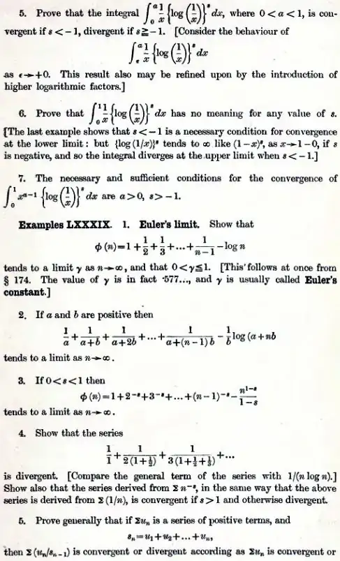

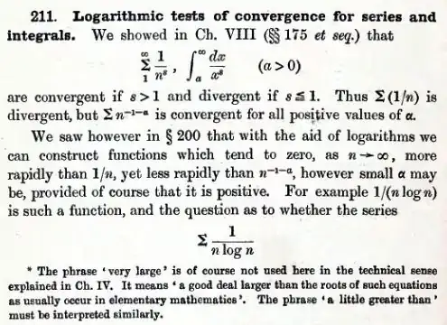

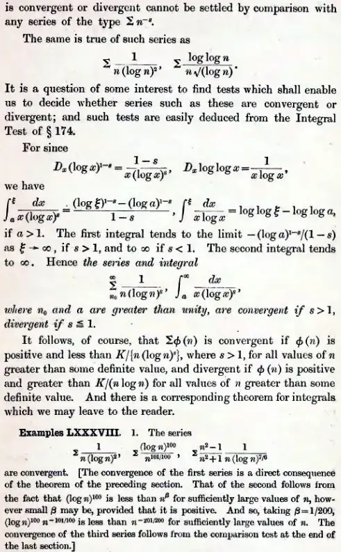

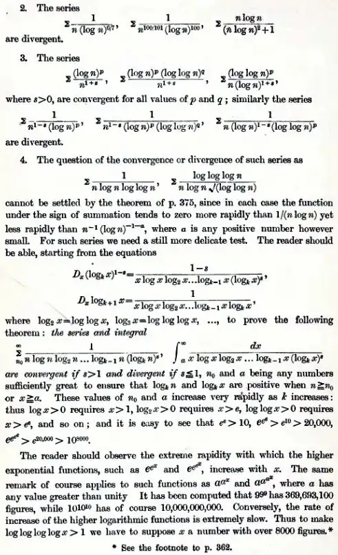

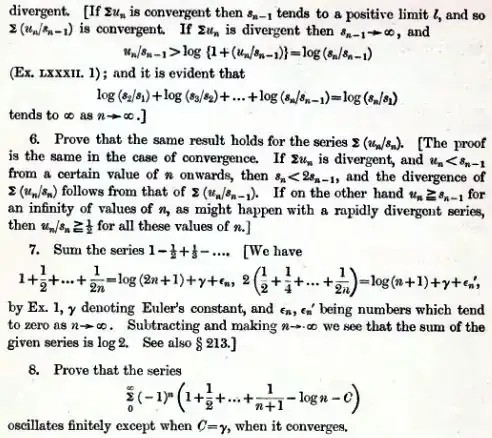

This is a special case of classic general logarithmic convergence tests. Some early work in asymptotics was motivated by attempts to determine the "boundary of convergence" in terms of various functions, e.g. log-exp functions. Below is a a very interesting excerpt from Hardy's classic "A course in pure mathematics". For further work see his "Orders of infinity" and see especially this very interesting paper by G. Fisher on Paul du Bois-Reymond's work on the boundary between convergence and divergence (where he discovered diagonalization before Cantor).
Note in particular the following very general result that is presented in the excerpt: the following series and integral are convergent if $\rm\ s > 1\ $ and divergent if $\rm\: s\le 1\ $ where $\rm\: n_0,\ a\ $ are any numbers large enough to ensure positivity of $\rm\ log_k x := \log \log \cdots \log x\:,\ $ iterated $\rm\:k\:$ times.
$$\rm \sum_{n_0}^\infty \frac{1}{n \log n\ \log_2 n\ \cdots\ \log_{k-1} n\ (\log_k n)^s } $$
$$\rm \int_{a}^\infty \frac{dx}{x \log x\ \log_2 x\ \cdots\ \log_{k-1} x\ (\log_k x)^s } $$
