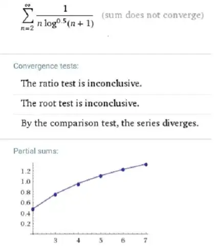

I have been trying to solve this problem for many hours, but I am lost. I would like to use the Comparison Test. However, any other test would be also OK.
I am interested not only in the exponent 0.5. I am interested in all the exponents that are elements of the interval (0,1).
log in the image is natural log.
I am posting "the solution" of WolframAlpha.
Thank you for your help!

    Is your question that you want a proof about the convergence or divergence of $$\sum_{n=2}^{\infty}\frac{1}{n\log^k(n+1)}$$ for all $k \in (0,1)$? In particular, a proof that uses the comparison test? – David Jan 31 '17 at 22:13
  • According to WolframAlpha the series diverges. I would prefer a proof that use the Comparison Test. But, any other test is also welcome. – Beginner Jan 31 '17 at 22:16
  • I used the integral test for a similar series that inside the log has n instead of (n+1). That series diverges. However, I cannot use it for the Comparison Test because that series is greater that the one of the problem. – Beginner Jan 31 '17 at 22:18
    Compare with $\sum_{n=2}^\infty\frac{1}{n\ln n}$, this one you can use the integral test to show the divergence. – Closure Jan 31 '17 at 22:18
    As the series is known to diverge, it suffices to show divergence for $k=1$ (the fastest decrease rate). –  Jan 31 '17 at 22:21
  • @FrankLu I checked and it is working! Great idea thank you so much! – Beginner Jan 31 '17 at 22:26
  • @YvesDaoust Excellent comment! Thank you! – Beginner Jan 31 '17 at 22:26
  • @FrankLu One question. What can I do if I need also 1 in the interval? For that point the series that you found does not work because the one of the problem is smaller, then I cannot apply the Comparison Test. – Beginner Jan 31 '17 at 22:53
  • @YvesDaoust The series that Frank Lu suggested does not work for k=1. May you help me with one that works for k=1? – Beginner Jan 31 '17 at 22:58
  • If starts at $k=1$ you can try $\sum_{k=1}^\infty\frac{1}{n\ln(n+1)}$. This one also works, but just need to be a little careful to make the argument rigorors. Essentially if you can prove that the tail of this series diverges, you are done. – Closure Jan 31 '17 at 23:54
