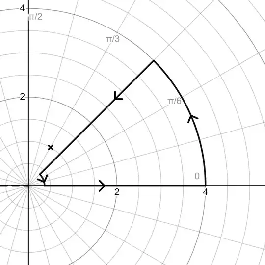

@Ron Gordon 's solution is also what I originally did and the solution development is very rigorous. for the purpose of evaluating $\int_{\mathfrak{R}+} \frac {ln(x)}{x^{n}-1}dx$, there is a much faster method which utilizes contour integration and Leibniz's theorem. $$\implies \int_{\mathfrak{R}+} \frac {x^{\xi -1}}{x+1}dx=\beta(\xi,1-\xi)={{\Gamma(\xi)\Gamma(1-\xi)} \over \Gamma (\xi+1-\xi)}=\pi cosec(\pi\xi)$$then by Leibniz's rule$$\int_{\mathfrak{R}+} \frac {x^{\xi -1}lnx}{x+1}dx=\int_{\mathfrak{R}+} {\partial \over {\partial \xi}} \frac {x^{\xi -1}}{x+1}dx={\frac {d}{d\xi}}\int_{\mathfrak{R}+} \frac {x^{\xi -1}}{x+1}dx=-\pi^{2}cosec(\pi \xi)cot(\pi \xi)$$ with these results it can be easily shown that $$\int_{\mathfrak{R}+} \frac {dx}{x^n+1}=\frac{\pi}{n}cosec(\frac{\pi}{n})$$ $\&$ $$ \int_{\mathfrak{R}+} \frac {lnxdx}{x^n+1}=-\frac{\pi^2}{n^2}cosec(\frac{\pi}{n})cot(\frac{\pi}{n})$$ with this in mind
consider this contour , with a pole at $z=e^{\frac{2\pi i}{n}}$enter image description here
a pizza contour with a branch cut from $(-\infty,0)$,$argz\in[-\pi,\pi]$ and the angle of the arc is $\pi \over n$. The inner radius is given by $\gamma$ and the outer radius by $\omega$. let us denote the outer arc by $\Gamma_{\omega}$, and the inner arc by $\Gamma_{\gamma}$ Because there are no poles inside the contour, $\implies \oint_c=0$ $$\implies \oint_c=0=\int_{\gamma}^{\omega}+\oint_{\Gamma_{\omega}}+\int_{\omega e^{\pi \over n}}^{\gamma e^{\pi \over n}}+\oint_{\Gamma_{\gamma}}$$ in taking the $\lim_{\gamma \rightarrow 0}$ and $\lim_{\omega \rightarrow \infty}$, the integrals over $\Gamma_{\omega}$ and $\Gamma_{\gamma}$ vanish. This can be shown both by ML inequality and by validating Dominated convergence theorem and then taking the limit inside. in doing so we get $$0=\int_{{\mathfrak{R}}+}\frac {lnx}{x^n-1}dx+\int_{\infty}^{0}\frac {ln(xe^{\frac {\pi i}{n}})}{x^n e^{\frac {\pi in}{n}}-1}e^{\frac {\pi i}{n}}dx=\int_{{\mathfrak{R}}+}\frac {lnx}{x^n-1}dx+\int_{{\mathfrak{R}}+}\frac {ln(x)+{\frac {\pi i}{n}}}{x^n+1}e^{\frac {\pi i}{n}}dx\implies \int_{{\mathfrak{R}}+}\frac {lnx}{x^n-1}dx=-e^{\frac {\pi in}{n}}\left(\int_{{\mathfrak{R}}+}\frac {ln(x)}{x^n+1}dx+{\frac {\pi i}{n}}\int_{{\mathfrak{R}}+}\frac{dx}{x^n+1} \right)=-e^{\frac {\pi in}{n}}\left(-\frac{\pi^2}{n^2}cosec(\frac{\pi}{n})cot(\frac{\pi}{n})+\frac{\pi^2 i}{n^2}cosec(\frac{\pi}{n})\right)=\frac{\pi^2}{n^2}\left( cot^{2}\left(\frac{\pi}{n}\right)+1\right)=\frac{\pi^2}{n^2}cosec^{2}\left(\frac{\pi}{n}\right)$$
