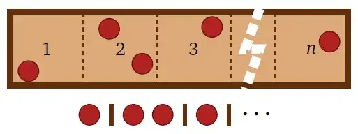

First, imagine an experiment where we have a box with $n$ compartments. We draw a number between $1$ and $n$ from an urn, place a ball in the corresponding compartment, and put the number back in the urn. This is repeated $k$ times, which gives some configuration of the box:
As indicated in the figure, this configuration is equivalent to a sequence of $k$ red balls and $(n-1)$ inner walls, i.e. the walls separating the compartments. It is possible to construct $(n-1+k)!$ such sequences (with regard to order). But since we only care about the number of balls in each compartment, some of these sequences are identical. Swapping two balls in the sequence, will not change the configuration of the box, and the total number of ways to permute the balls is $k!$. Likewise, the inner walls can be permuted in $(n-1)!$ ways. This gives \begin{align*} \frac{(n-1+k)!}{(n-1)!k!}=\binom{n-1+k}{k} \end{align*} possible ways to choose $k$ out of $n$ objects without regard to order and with replacement.
In respect to the problem $x_1+\ldots+x_n=k$, this is exactly the same problem as placing the balls in the compartments. Think of $x_1$ as the number of balls in compartment 1, $x_2$ the number in compartment 2 etc. In total, there are $k$ balls, which gives the equation.
