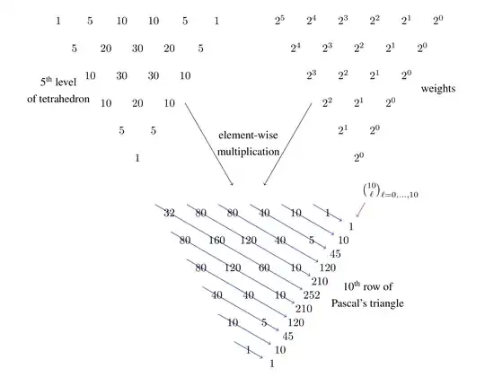

  • Visually, the relation also has a potentially interesting interpretation: As the binomial coefficients correspond to Pascal's triangle, so do the trinomial coefficients correspond to Pascal's tetrahedron (or Pascal's pyramid). Therefore, $(*)$ means that certain weighted sums within the $n^{\mathrm{th}}$ level of Pascal's tetrahedron give the $(2n)^{\mathrm{th}}$ row of Pascal's triangle, as illustrated below for $n=5$.
