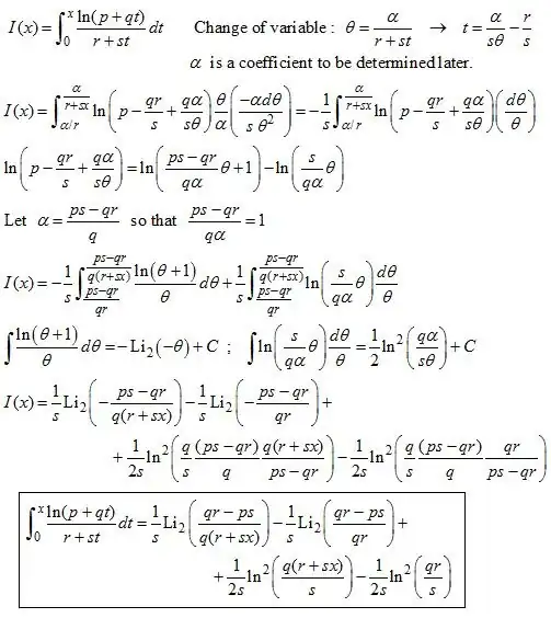

Among various ways to do it, this one is simple :
JJacquelin
  • 68,401
  • 40
  • 91
  • Thank you. I have indeed learnt from this answer. +1. If you don't mind, may I ask where you got the idea of substituting $\displaystyle \theta=\frac{\alpha}{r+st}$ from? It is quite a brilliant and effective substitution. Thanks! – SuperAbound Aug 11 '14 at 00:11
    I have tried a more general substitution on the form $\theta=(r+st)^c$. Then, it apprears that $c=-1$ facilitates the simplification of the equation. – JJacquelin Aug 11 '14 at 04:28
