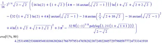

With some help from a CAS I got this result with only one dilogarithm term: $$I=\frac{\sqrt[4]2\sqrt{2-\sqrt2}}{16}\\\left\{\left[16\ln2+\left(1+\sqrt2\right)\left(4\pi-16\arctan\sqrt{\sqrt2-1}\right)\right]\ln\left(1+\sqrt2+\sqrt{2+2\sqrt2}\right)\\-\Big(32\left(1+\sqrt2\right)\ln2+4\pi\Big)\arctan\sqrt{\sqrt2-1}-3\pi\arctan\frac{2\sqrt{2+10\sqrt2}}7\\-16\arctan^2\sqrt{\sqrt2-1}+4\ln^2\!\left(1+\sqrt2+\sqrt{2+2\sqrt2}\right)\\+3\pi^2-\frac{32}{\sqrt{2-\sqrt2}}\,\Re\left[\left(-1\right)^{5/8}\operatorname{Li}_2\!\left(2i\left( 1+\sqrt{1+i}\right)\right)\right]\right\}.$$
Update: It was suggested in comments that this expression gives a numerically incorrect result when evaluated with Maple. Here is what I got with Maple 18:
This value numerically matches the integral. I also checked it with Mathematica 10 and it gave the same numeric result.

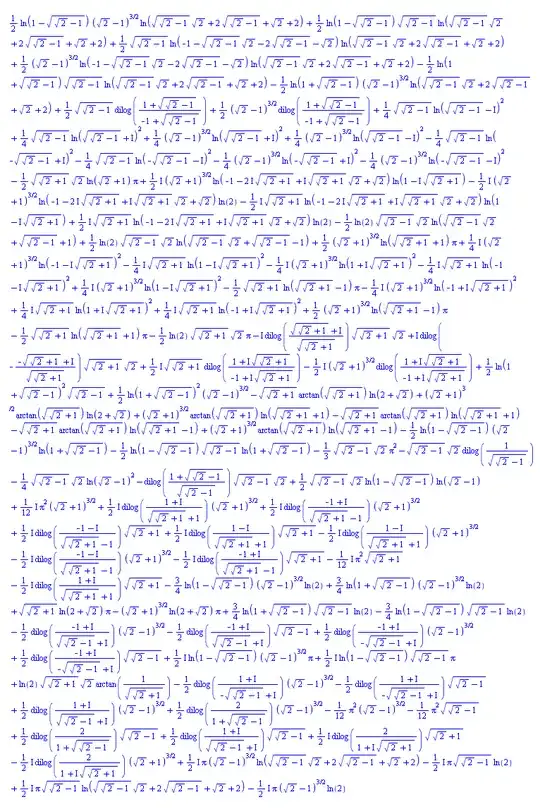

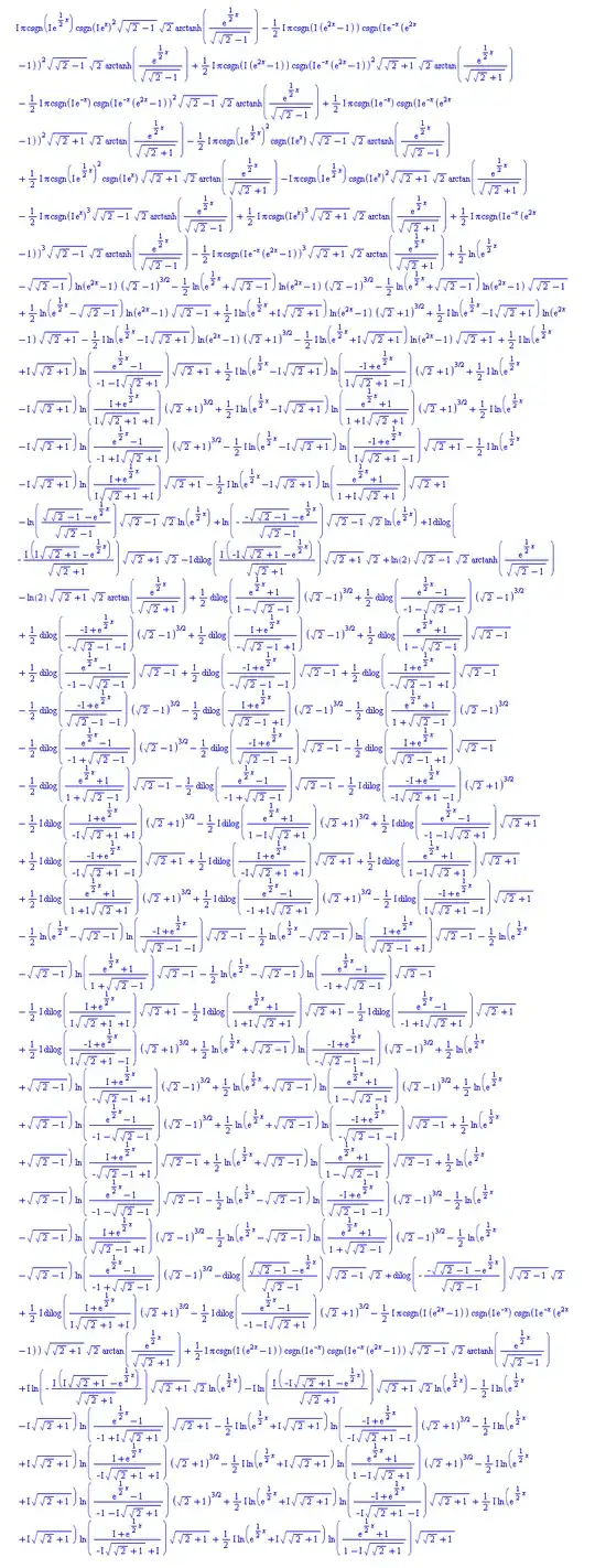

I calculated for you the indefinite integral $\int f(x) \ dx$. It is too long to render with $\LaTeX$, so I paste here the raw Maple output:
After that I calculated the definite integral $\int_0^{\infty} f(x) \ dx$. Here is the closed form:
Which is by 100 digits precision: $4.253149825368695481030630266176679795147658282 \\ 387249226057297960587772473334190569825379100016048097$
