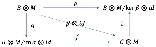

Notation: In what follows all tensor products are over $R$ and $id$ means $id_M$.
Dummit and Foote has this rather horrible proof for $\text{im }\alpha\otimes id=\ker{\beta\otimes id}$ with the advantage of not relying on the (right-)exactness of any other functor, but rather on exactness at $C\otimes M$ and that $\text{im }\alpha\otimes id\subseteq\ker{\beta\otimes id}$. I find the following rendition of it more complete and easier to follow:
Define quotient $p:B\otimes M \to B\otimes M/\ker{\beta\otimes id}$. Since $\beta\otimes id$ is surjective we get an isomorphism $i:C\otimes M\to B\otimes M / \ker{\beta\otimes id}$ such that $ p = i \circ \beta\otimes id$ so that the upper triangle commutes.
Now define quotient $q:B\otimes M\to B\otimes M / \text{im }\alpha\otimes id$. Since $\text{im }\alpha\otimes id \subseteq \ker {\beta \otimes id}$, there is an $f:B\otimes M/ \text{im }\alpha\otimes id \to C\otimes M$ such that $\beta\otimes id = f\circ q$, so that the lower triangle commutes.
If by providing a left-inverse we show that $f$ is injective, then so would be $i\circ f$. So we finally get $$(i\circ f)\big(q(\ker{\beta\otimes id})\big)=(i\circ f\circ q)(\ker{\beta\otimes id})=p(\ker{\beta\otimes id})=0$$ $$\Rightarrow q(\ker{\beta\otimes id})=0\Rightarrow \ker{\beta\otimes id} \subseteq \text{im }\alpha\otimes id$$ Commutative diagram
Now we contrive the left-inverse $g:C\otimes M \to B\otimes M / \text{ im }\alpha\otimes id$:
For $c\in C,m\in M$, find $b\in B, \beta(b)=c$. Note that if $c=0$ we would get $$b\in \ker \beta = \text{im }\alpha\Rightarrow b\otimes m \in \text{im }\alpha\otimes id \Rightarrow q(b \otimes m)=0$$ So there is a well-defined homomorphism of abelian groups $\tilde g:C\times M\to B\otimes M / \text{im } \alpha\otimes id, (c,m)\mapsto q(b\otimes m)$. Now for any $r\in R$: $$\beta(br)=cr \Rightarrow \tilde g(cr,m)=q(br\otimes m)=q(b\otimes rm)=\tilde g(c,rm)$$ So $\tilde g$ is $R$-balanced and hence factors through some $g:C\otimes M \to B\otimes M / \text{im } \alpha\otimes id$.
We finally check that $g\circ f$ is the identity map. Let $b \in B, m\in M$. Then $$(f\circ q)(b\otimes m)=\beta(b)\otimes m\Rightarrow (g\circ f \circ q)(b\otimes m)=q(b\otimes m)$$ So $g\circ f$ acts as identity on elements of the form $q(b\otimes m)$. But simple tensors generate all of $B\otimes M$ and $q$ is surjective, so $g\circ f$ is in fact the identity on $B\otimes M / \text{im } \alpha\otimes id$.
