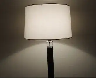

Today, I encountered a rather interesting problem in a waiting room:
$\qquad \qquad \qquad \qquad$enter image description here
Notice how the light is being cast on the wall? There is a curve that defines the boundary between light and shadow. In my response below, I will prove, algebraically, that this curve is a hyperbola. I'm also interested in seeing a variety of other solutions, so please feel free to post your own.

To begin, I noted two things. Given how light works, the curve must be a radial projection (from the light source) of the bottom boundary of the shade (a circle) onto the wall. Second, only the half of the circle closest to the wall would actually contribute to the shadow on the wall, and thus the curve. And so begins the math:
In this particular waiting room, the shade was actually touching the wall. That is, there was a single point on the bottom boundary of the shade touching the wall, which was the point at the 'apex' of this curve where the shadow began. Therefore, I imagined the scenario as follows:
The bottom boundary of the shade can be represented as the unit circle $\alpha = \langle \cos(\theta) + 1, \sin(\theta), 0 \rangle$. The wall can be thought of as the $yz$-plane, and perhaps the light source was centered at $P = (1, 0, 1)$. Note that the half of the circle contributing to the shadow is $\frac{\pi}{2} \leq \theta \leq \frac{3\pi}{2}$.
Next, recall that the curve is a radial projection of the circle, so we first wish to find a parametrization of the line from $P$ to an arbitrary point on the circle $\alpha$. Such a parametrization is as follows: $l(t) = \langle 1 + \cos(\theta)t, \sin(\theta)t, 1-t \rangle$. Note that at $t = 0$, we are at the point $P$, and at $t = 1$, we are at the point $\langle 1 + \cos(\theta), \sin(\theta), 0 \rangle$ on the circle.
We want to know where this family of lines intersects the $yz$-plane. Well, the $x$-coordinate at the intersection points is $0$, so we get the following equations:
$$x = 1 + \cos(\theta)t = 0$$ $$y = \sin(\theta)t$$ $$z = 1 - t$$
Hence, $t = -\sec(\theta)$. Plugging this in, we get the following system of equations describing the curve in the $yz$-plane:
$$y = -\tan(\theta)$$ $$z = 1 + \sec(\theta)$$
For simplicity, we can just pretend we're back in the $xy$-plane, and $x = -\tan(\theta)$ and $y = 1 + \sec(\theta)$. From here, we can get out of a parametrized equation and into rectangular form by noting that $y^2 - x^2 - 2y = 0$.
Recall that a general equation $A_{xx}x^2 + 2A_{xy}xy + A_{yy}y^2 + 2B_xx + 2B_yy + C = 0$ for constants $A_{\circ \circ}$ and $B_{\circ}$ describes a hyperbola provided that $ \det \left[ \begin{array}{ c c } A_{xx} & A_{xy} \\ A_{xy} & A_{yy} \end{array} \right] < 0$. Well, in our case, $A_{xx} = -1$, $A_{xy} = 0$, and $A_{yy} = 1$.
Therefore, we conclude that the curve is a hyperbola!

    Nices answer, but you could have guessed: the conic projection of a circle is a conic, and here it's obviously unbounded. – Jean-Claude Arbaut May 27 '14 at 21:28
  • @Jean-Claude: That doesn't rule out a parabola? – Ted Shifrin May 27 '14 at 21:29
  • @TedShifrin Actually, it does. Section of a cone by a plane parallel to the axis must be a hyperbola (or two intersecting lines, but here the light source is not on the wall) – Jean-Claude Arbaut May 27 '14 at 21:43
    The intersection of a right cone with a plane not through the cone's vertex is a circle if the plane is perpendicular to the axis of the cone, and a parabola if the plane is parallel to a plane through the vertex, tangent to the cone. Any other plane that produces a bounded conic produces an ellipse, and all other planes produce hyperbolas. But observation of the shadow a lampshade casts on a wall is a great way to motivate the study of conics. – David K May 27 '14 at 21:44
  • @Jean-Claude: I was merely addressing your saying "here it's obviously unbounded," as if to suggest unboundedness implied hyperbola! – Ted Shifrin May 27 '14 at 21:45
  • @TedShifrin No, I knew the answer was incomplete, but I thought suggesting the idea was enough ;-) – Jean-Claude Arbaut May 27 '14 at 21:46
    In fact, isn't that what the mathematical term "obviously" means? :-) – David K May 27 '14 at 21:47
  • Nevertheless, the parametric approach is very instructive, and one can rather easily rediscover all basic results of perspective, with vanishing line, etc. You simply start with a point (the eye, equivalent of the light source here), a plane (the wall), and compute projection of lines, circles... – Jean-Claude Arbaut May 27 '14 at 21:54
    Greatly enjoyed the feedback everyone. Related to David's comment, an approach similar to mine could probably be used to prove that each of the different ways of slicing a cone will yield its corresponding conic section. Of course, if you already have those results, then Jean-Claude's approach is a lot faster. – Kaj Hansen May 27 '14 at 23:05

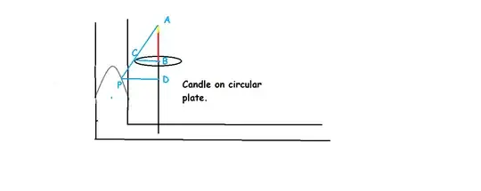

Oh... this question was my homework a year ago, and this is my proof which is short as per my laziness.
The bad grey drawing is the locus required. Obviously, for this part the light rays just touch the plate. Now $$\dfrac{PA}{PD}=\dfrac{CA}{CB}=\text{constant}>1$$
Hence, the locus is a hyperbola as ratio of distance from the top of candle and line of candle(extended) is ...
This case is similar to the lamp except the fact that there is darkness below and light above the boundary as contrary to a lamp. But this has no effect on the boundary.
