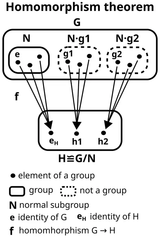

Here is a simplified diagram which illustrates the theorem, which tells us that every homomorphism looks like this:
where:
  • f is an homomorphism from G to H
  • N is a normal subgroup of G
  • H = G/N is the image of f, also known as the "quotient group"
  • e is the identity element of G
  • $e_H$ is the identity element of H
  • h1 and h2 arbitrarily selected non-identity elements of H
  • g1 and g2 are any arbitrarily selected elements such that $f(g1) = h1$ and $f(g2) = h2$.
    Since an homomorphism is not necessarily bijective, there are in general several possible choices for $g1$ and $g2$ with that property.
  • f maps N to $e_H$, $N \cdot g1$ to h1 and $N \cdot g2$ to g2
  • $N \cdot g1$ and $N \cdot g2$ are two cosets of N when it is multiplied by g1 and g2 respectively.
    $N \cdot g1$ contains all elements $g$ such that $f(g) = h1$.
  • each coset corresponds to one of the elements of H which they map to: N
  • we see that N is the kernel of f by the definition of kernel, because N is the inverse image of $e_H$
  • from this it is clear how the structure of the quotient G/N is simpler than the original G: we collapsed the structure of the entire normal group N to a single point! Therefore, an homomorphism is basically a simplification function that ignores the structure of the normal group while doing its transformation

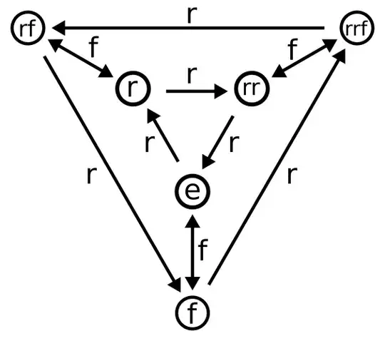

Example: the dihedral group of order 6 ($C_2 = D_3/C_3$)
This is the group of rotations and flips of a triangle. It has 3 rotations, with 2 flips states each, so 6 elements in total. Here's a Cayley-like graph of it:
SVG source.
Legend:
  • r: clockwise rotation
  • f: flip
This is the smallest non-Abelian group, so we might expect to see some more interesting behavior, because every Abelian group is just direct product of cyclic groups, and in $G = H \times I$, both $H$ and $I$ are normal in $G$, so everything is simple and boring.

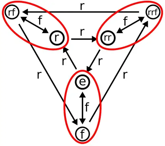

Let's work that out more precisely. As usual, we start with the normal subgroup $C_3$, which is going to be the preimage of the identity.
Let's apply other transformations to it, to see that each transformation falls in either of the two image elements (flip or non-flip):
$$ \begin{align} e C_3 &= \{e, r, rr\} \\ r C_3 &= \{r, rr, e\} = \{e, r, rr\} \\ rr C_3 &= \{rr, e, r\} = \{e, r, rr\} \\ f C_3 &= \{f, fr, frr\} \\ rf C_3 &= \{rf, rfr, rfrr\} = \{rf, f, fr\} = \{rf, f, rrf\} = \{f, rf, rrf\} \\ rrf C_3 &= \{rrf, rrfr, rrfrr\} = \{f, rf, rrf\} \\ \end{align} $$
and the same holds from the other side $C_3 e$, $C_3 r$, $C_3 rr$ and so on. So we see everything works out nicely if we take:
  • $e_H$: image of $\{e, r, rr\}$
  • $1_H$: image of $\{f, rf, rrf\}$
By the way, note that we can write $G = C_2C_3$ (the [product of two subgroups), and this type of composition is called the semi-direct product and written as $C_3 \rtimes C_2$.

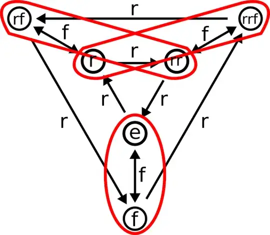

We could be tempted to select:
but that doesn't work! E.g. if we apply:
  • r to r, it goes to rr
  • r to rf, it goes to f, which is in the equivalent class of the identity, so another equivalence than rr!
Therefore, we see that we can't make the homomorphism like that, as it won't be distributive over the domain's operation.

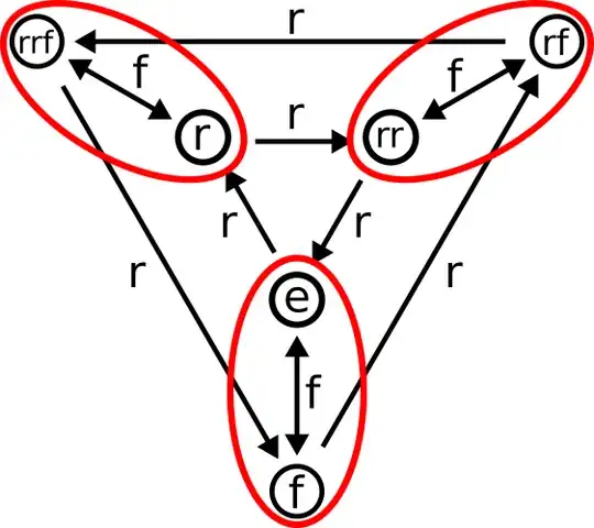

Let's try another one:
Hmmm... that one seems to work, why is that? The reason is that we had previously only checked the Cayley graph where the arrow r moves x to xr, i.e. a transformation after.
If we take the other graph, of the "transformation before" operation, then our second choice fails there because the graph is a bit different:
and so our attempt fails like the previous one:
e
and there is no choice that works for both.

The normal subgroups of $G$ are all the sets, which appear as kernel of group-homomorphisms $G \rightarrow H$.
Subgroups are the sets, which appear as images of group-homomorphism $H \rightarrow G$.
