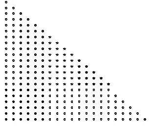

I will post just a sketch of different solution, which I quite like. (With the hope that OP can do the rest of work by himself and/or someone will be able to provide some links to materials where similar approach is used and the details are not omitted.)
I like this approach because a) it has many pictures; b) it can be explained to someone who knows nothing about Pell's equation. (In fact, similar approach can be used for some special cases of Pell's equation, you can have a look here. These notes are written in Slovak language, but I guess that the equations and pictures there are sufficient to understand it.)
I have learned about this from diploma thesis of my classmate some years ago. (I do not know the exact title - I only have a ps file without title pages.) In fact, the notation I am using here and some of the pictures are taken from her thesis. I apologize for the quality of the pictures, but I did not know a good way how to convert them from ps format.
Let us start with the first picture.
Triangle=square Triangle=square
$\triangle_m = \square_n$ $\Rightarrow$ $\triangle_{2n-m-1}=2\triangle_{m-n}$
(I guess this is self-explaining - we basically just gave the intersection away. One only has to be careful with one thing - we must not forget to subtract one. We are not working with areas of triangles and squares, but with the number of stones that are placed in them.)
Now we have to solve a new problem - when is one triangular number twice as large as another one. We can try our luck with a picture again.
Triangle=2triangles Triangle=2trianglees
We see that $2\triangle_p=\triangle_q$ $\Rightarrow$ $\square_{q-p}=\triangle_{2p-q}$.
Combining the above, with some algebraic manipulation, we get that from each solution $(m,n)$ we get a new solution of the form $(3m-4n+1,3n-2m-1)$.
