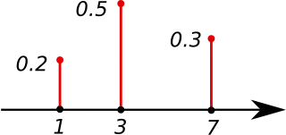

One of my graduate school professors, Erhan Cinlar, used to give the following analogy to explain the intuitive difference between the Lebesgue integral and the Riemann integral.
Suppose you have a pile of coins of different denominations, and you want to know how much money you have. The Riemann integral is like picking up the coins, one-by-one, and adding the denomination of each to a running total. The Lebesgue integral is like sorting the coins by denomination first, and then getting the total by multiplying each denomination by how many you have of that denomination and then adding up those numbers. The methods are different, but you obtain the same result by either method.
In the same way, when both the Riemann integral and the Lebesgue integral are defined, they give the same value. As others have said, though, there are functions for which the Lebesgue integral is defined but the Riemann integral is not, and so in that sense the Lebesgue integral is more general than the Riemann.
